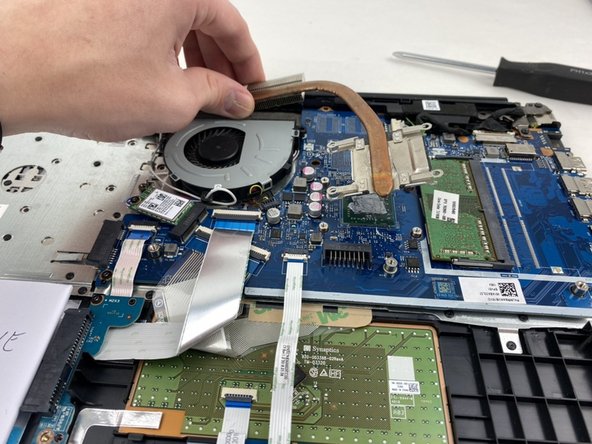

  4. HP 15-db0015dx Fan and Heat Sink Replacement, Fan and Heat Sink: crwdns2935265:04crwdnd2935265:01crwdnd2935265:01crwdne2935265:0
    • Remove the screw on the fan with a Phillips #0 screwdriver.

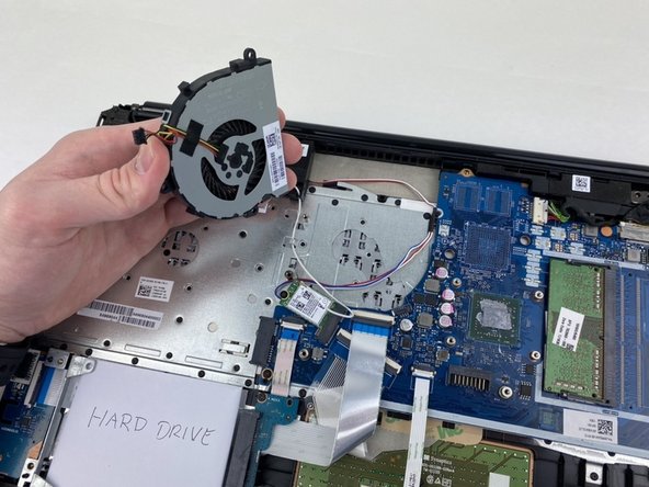

  5. HP 15-db0015dx Fan and Heat Sink Replacement: crwdns2935265:05crwdnd2935265:01crwdnd2935265:03crwdne2935265:0 HP 15-db0015dx Fan and Heat Sink Replacement: crwdns2935265:05crwdnd2935265:02crwdnd2935265:03crwdne2935265:0 HP 15-db0015dx Fan and Heat Sink Replacement: crwdns2935265:05crwdnd2935265:03crwdnd2935265:03crwdne2935265:0
    • Lift the fan upward slightly.
    • Be careful not to pull hard as the wires could become damaged.
    • Disconnect the fan cable by pinching on the sides of the connectors and sliding it out.
    • Lift the rest of the way to remove the fan.

    • Remove the four screws with a Phillips #00 screwdriver.
    • Lift and remove the heat sink.
    • Remember to clean and reapply the thermal paste during reinstallation to retain proper heat transfer from the CPU. Check out this Thermal Paste Application guide if you are unfamiliar with the process.

Hey great guide! Just a quick question: is the material directly under the copper pipe (on the CPU side) also thermal paste which needs to be swapped out? Or is ist a static part of the fan/pipe/CPU cover? Thanks in advance!
Aaron P - crwdns2934203:0crwdne2934203:0
It's best to remove the material on both the CPU side and the attached fan side.
