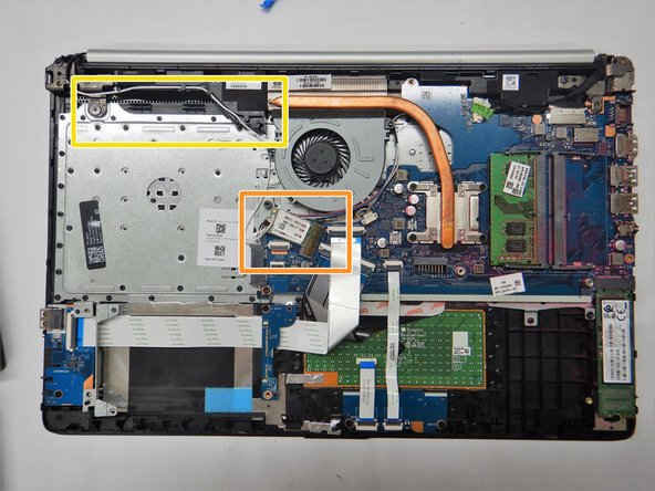

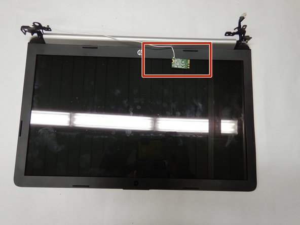

    • Remove the 3 mm Phillips #0 screw securing the WLAN card in place.
    • Carefully remove the WLAN card from the motherboard.
    • Gently remove the antenna cable from the wire guides in the speaker and chassis.
    • Place WLAN card off to the side being careful not to pull on the antenna cable.
    • The antenna cable is soft and can easily be damaged.

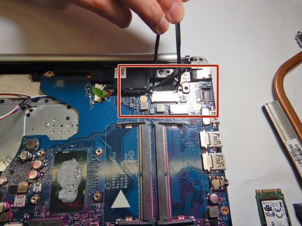

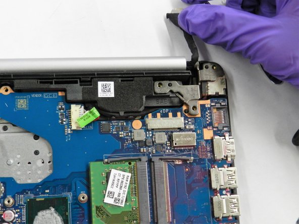

    • Carefully use the metal tweezers to remove the display connection to the motherboard.

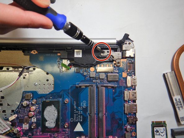

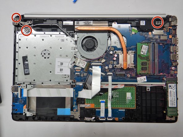

    • Use the Phillips #1 screwdriver to disconnect the display hinges from the base of the laptop.

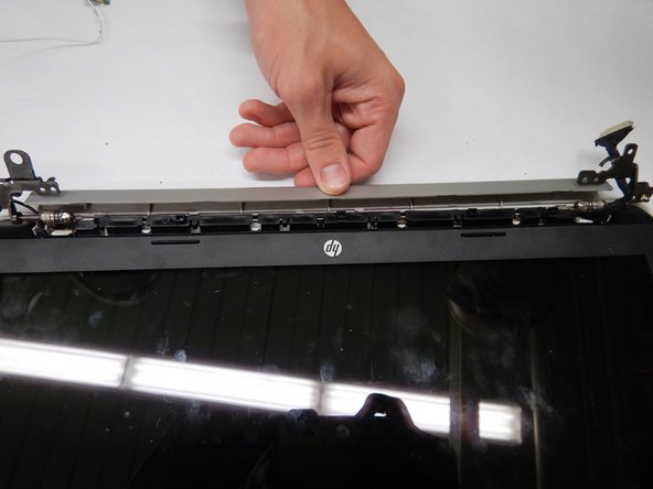

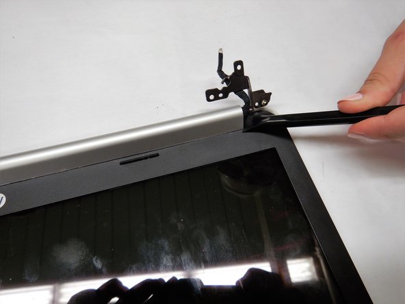

    • Carefully use the pry tool to separate the screen side of the hinge cover from the screen.
    • Rotate the hinge cover away from the screen to remove it from the screen.

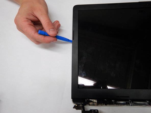

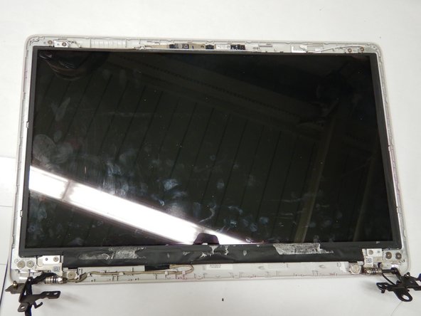

    • Starting from the area near the hinges, gently remove the adhesive display bezel from around the screen using the iFixit opening tool.
  14. HP 15-da0012dx Screen Replacement: crwdns2935265:014crwdnd2935265:01crwdnd2935265:02crwdne2935265:0 HP 15-da0012dx Screen Replacement: crwdns2935265:014crwdnd2935265:02crwdnd2935265:02crwdne2935265:0

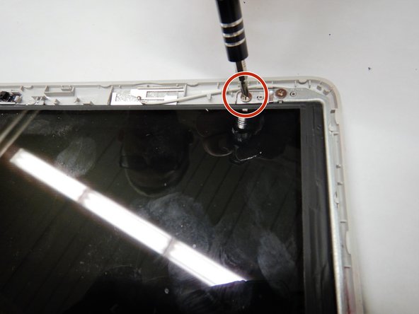

    • Use the Phillips #1 screwdriver to remove the four 3.0 mm screws securing the screen to the top cover.
  15. HP 15-da0012dx Screen Replacement: crwdns2935265:015crwdnd2935265:01crwdnd2935265:02crwdne2935265:0 HP 15-da0012dx Screen Replacement: crwdns2935265:015crwdnd2935265:02crwdnd2935265:02crwdne2935265:0
    • Carefully lift the screen, being aware to not pull on the display cable connecting the screen to the top cover.
    • Gently remove the display cable from the back of the screen.
    • Remove the screen from the display assembly.
