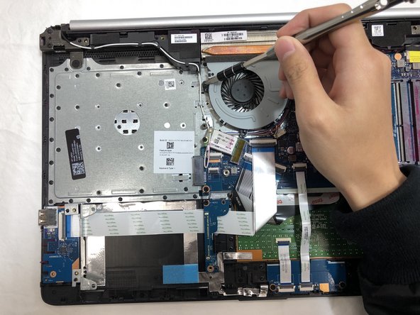

    1. HP 15-da0012dx Fan Replacement, Fan: crwdns2935265:08crwdnd2935265:01crwdnd2935265:02crwdne2935265:0 HP 15-da0012dx Fan Replacement, Fan: crwdns2935265:08crwdnd2935265:02crwdnd2935265:02crwdne2935265:0
      • Using the Phillips #1 screwdriver, remove the single 6.0 mm screw holding the fan in place.
    2. HP 15-da0012dx Fan Replacement: crwdns2935265:09crwdnd2935265:01crwdnd2935265:01crwdne2935265:0
      • Using the tip of the blue plastic opening tool or your fingernail, pull the connector for the fan cable straight out of the socket.
      • To reinstall the cable, push the connector straight into the socket.

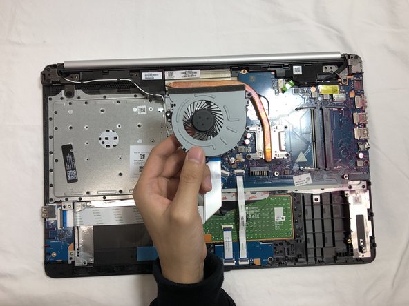

    3. HP 15-da0012dx Fan Replacement: crwdns2935265:010crwdnd2935265:01crwdnd2935265:02crwdne2935265:0 HP 15-da0012dx Fan Replacement: crwdns2935265:010crwdnd2935265:02crwdnd2935265:02crwdne2935265:0
      • Lift the fan from the computer.

In Step 9, the instructions are not clear "Using the tip of the blue plastic opening tool or your fingernail, pull the connector for the fan cable straight out of the socket.". By straight out, that could mean straight up. However, the connector needs to be pulled straight back towards the fan body. It is difficult to see which way the connector should go. Otherwise, the instructions are excellent.
