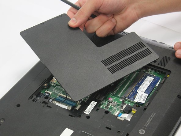

    3. HP 15-d076nr RAM Replacement: crwdns2935265:03crwdnd2935265:01crwdnd2935265:02crwdne2935265:0 HP 15-d076nr RAM Replacement: crwdns2935265:03crwdnd2935265:02crwdnd2935265:02crwdne2935265:0
      • Carefully pry the middle panel up using a plastic spudger or other prying tool .
      • Pull the panel away from the laptop and set it off to the side.

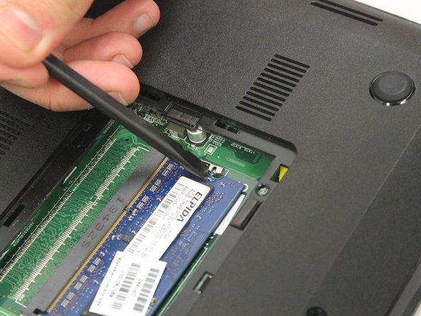

    4. HP 15-d076nr RAM Replacement: crwdns2935265:04crwdnd2935265:01crwdnd2935265:01crwdne2935265:0
      • Locate the RAM in the exposed area.

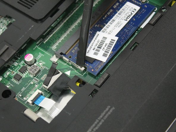

    5. HP 15-d076nr RAM Replacement: crwdns2935265:05crwdnd2935265:01crwdnd2935265:03crwdne2935265:0 HP 15-d076nr RAM Replacement: crwdns2935265:05crwdnd2935265:02crwdnd2935265:03crwdne2935265:0 HP 15-d076nr RAM Replacement: crwdns2935265:05crwdnd2935265:03crwdnd2935265:03crwdne2935265:0
      • Locate the latches on the RAM.
      • Slide the latches away from the RAM using a plastic spudger.
      • The RAM might spring out.
    6. HP 15-d076nr RAM Replacement: crwdns2935265:06crwdnd2935265:01crwdnd2935265:01crwdne2935265:0
      • Remove the RAM.
