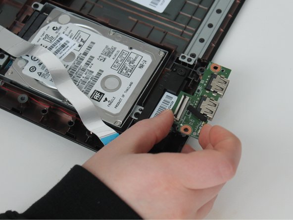

  29. HP 15-d076nr Onboard Speakers Replacement: crwdns2935265:029crwdnd2935265:01crwdnd2935265:02crwdne2935265:0 HP 15-d076nr Onboard Speakers Replacement: crwdns2935265:029crwdnd2935265:02crwdnd2935265:02crwdne2935265:0
    • Remove the Phillips PM2.5×5.0 screw connected to the USB board.
    • Remove the USB board.

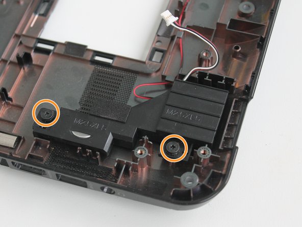

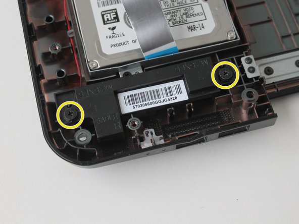

  30. HP 15-d076nr Onboard Speakers Replacement: crwdns2935265:030crwdnd2935265:01crwdnd2935265:03crwdne2935265:0 HP 15-d076nr Onboard Speakers Replacement: crwdns2935265:030crwdnd2935265:02crwdnd2935265:03crwdne2935265:0 HP 15-d076nr Onboard Speakers Replacement: crwdns2935265:030crwdnd2935265:03crwdnd2935265:03crwdne2935265:0
    • Locate the two speaker modules.
    • Remove the two Phillips PM2.5×4.0 screws on the bottom left module.
    • Remove the two Phillips PM2.5×4.0 screws on the bottom right module.

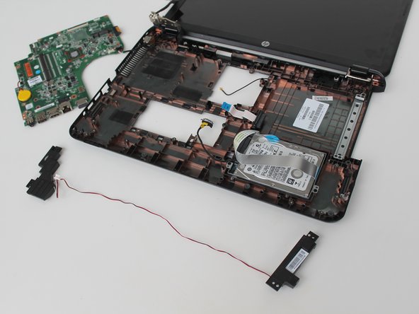

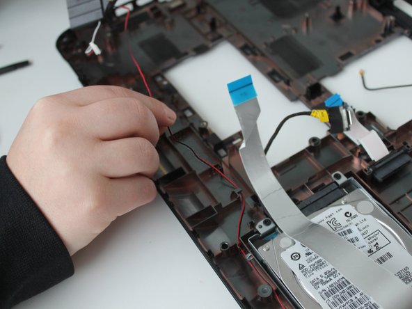

  31. HP 15-d076nr Onboard Speakers Replacement: crwdns2935265:031crwdnd2935265:01crwdnd2935265:03crwdne2935265:0 HP 15-d076nr Onboard Speakers Replacement: crwdns2935265:031crwdnd2935265:02crwdnd2935265:03crwdne2935265:0 HP 15-d076nr Onboard Speakers Replacement: crwdns2935265:031crwdnd2935265:03crwdnd2935265:03crwdne2935265:0
    • Slowly lift the speakers away from the laptop body.
    • Remove the red and black cable, connecting the two speaker modules, from its routing.
    • Remove the speakers from the laptop body.
