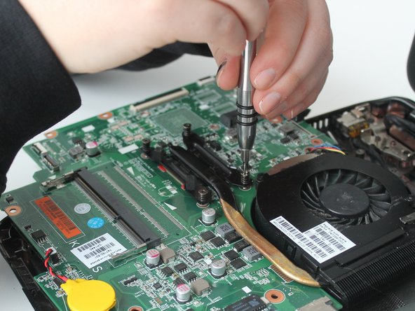

    1. HP 15-d076nr Fan Replacement, Fan: crwdns2935265:028crwdnd2935265:01crwdnd2935265:02crwdne2935265:0 HP 15-d076nr Fan Replacement, Fan: crwdns2935265:028crwdnd2935265:02crwdnd2935265:02crwdne2935265:0
      • Carefully loosen the four screws on the processor heat sink.
      • The screws do not come out. They are retained by the heat sink.
    2. HP 15-d076nr Fan Replacement: crwdns2935265:029crwdnd2935265:01crwdnd2935265:01crwdne2935265:0
      • Disconnect the red-yellow-blue-black cable, next to the fan, on the motherboard.
      • You may need to wiggle it
    3. HP 15-d076nr Fan Replacement: crwdns2935265:030crwdnd2935265:01crwdnd2935265:01crwdne2935265:0
      • Remove the fan.
