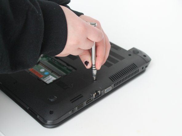

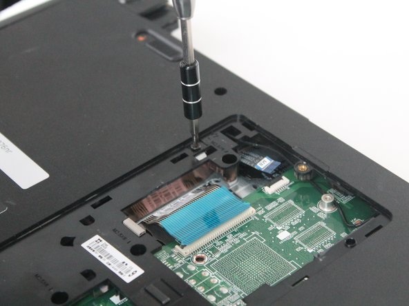

  6. HP 15-d076nr Charge Port Replacement: crwdns2935265:06crwdnd2935265:01crwdnd2935265:01crwdne2935265:0
    • Locate the small screw on the panel at the center of the laptop.
    • Loosen the small screw using a Philips # 1 screwdriver.
    • The screw does not come free from the panel. It only needs to be loosened enough so that the panel can be lifted/pried.

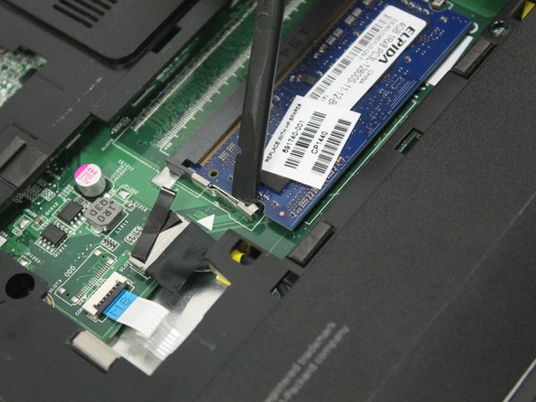

  11. HP 15-d076nr Charge Port Replacement, Motherboard: crwdns2935265:011crwdnd2935265:01crwdnd2935265:01crwdne2935265:0
    • Locate the RAM in the exposed area.

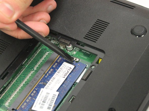

  12. HP 15-d076nr Charge Port Replacement: crwdns2935265:012crwdnd2935265:01crwdnd2935265:03crwdne2935265:0 HP 15-d076nr Charge Port Replacement: crwdns2935265:012crwdnd2935265:02crwdnd2935265:03crwdne2935265:0 HP 15-d076nr Charge Port Replacement: crwdns2935265:012crwdnd2935265:03crwdnd2935265:03crwdne2935265:0
    • Locate the latches on the RAM.
    • Slide the latches away from the RAM using a plastic spudger.
    • The RAM might spring out.
  13. HP 15-d076nr Charge Port Replacement: crwdns2935265:013crwdnd2935265:01crwdnd2935265:01crwdne2935265:0
    • Remove the RAM.

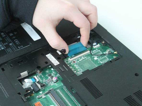

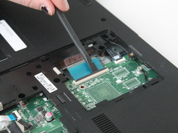

  14. HP 15-d076nr Charge Port Replacement: crwdns2935265:014crwdnd2935265:01crwdnd2935265:03crwdne2935265:0 HP 15-d076nr Charge Port Replacement: crwdns2935265:014crwdnd2935265:02crwdnd2935265:03crwdne2935265:0 HP 15-d076nr Charge Port Replacement: crwdns2935265:014crwdnd2935265:03crwdnd2935265:03crwdne2935265:0
    • Locate the ribbon cables.
    • Pry up the black tabs on the connectors and disconnect both of the ribbon cables.

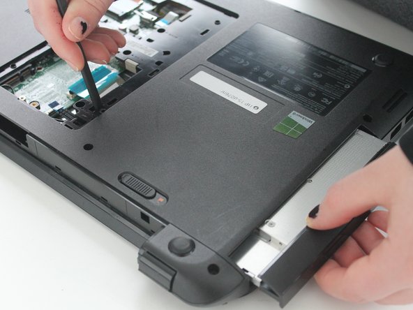

  16. HP 15-d076nr Charge Port Replacement: crwdns2935265:016crwdnd2935265:01crwdnd2935265:02crwdne2935265:0 HP 15-d076nr Charge Port Replacement: crwdns2935265:016crwdnd2935265:02crwdnd2935265:02crwdne2935265:0
    • Push down the tab that is located by the DVD drive screw.
    • Take the DVD drive in one hand, and using the plastic spludger, push the tab down, and out.

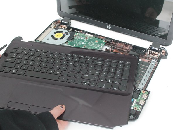

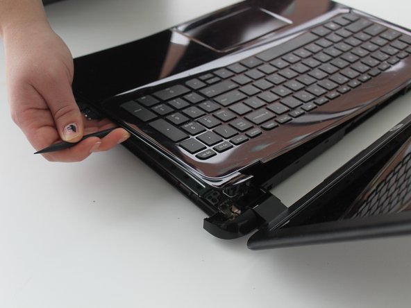

  18. HP 15-d076nr Charge Port Replacement: crwdns2935265:018crwdnd2935265:01crwdnd2935265:03crwdne2935265:0 HP 15-d076nr Charge Port Replacement: crwdns2935265:018crwdnd2935265:02crwdnd2935265:03crwdne2935265:0 HP 15-d076nr Charge Port Replacement: crwdns2935265:018crwdnd2935265:03crwdnd2935265:03crwdne2935265:0
    • Flip the laptop over, and open it as if you were using it.
    • Gently, remove the laptop cover/keyboard from the laptop using the plastic spudger.
    • When you remove the cover/keyboard, the laptop will become top heavy.

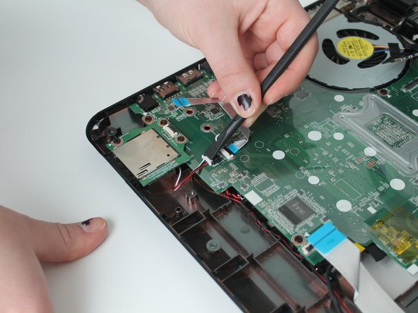

  20. HP 15-d076nr Charge Port Replacement: crwdns2935265:020crwdnd2935265:01crwdnd2935265:02crwdne2935265:0 HP 15-d076nr Charge Port Replacement: crwdns2935265:020crwdnd2935265:02crwdnd2935265:02crwdne2935265:0
    • Lift the black tabs, and disconnect the three ribbon cables.
    • Disconnect the red-black-white speaker cable located in the lower left corner.

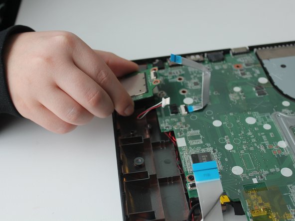

  21. HP 15-d076nr Charge Port Replacement: crwdns2935265:021crwdnd2935265:01crwdnd2935265:02crwdne2935265:0 HP 15-d076nr Charge Port Replacement: crwdns2935265:021crwdnd2935265:02crwdnd2935265:02crwdne2935265:0
    • Remove the three Phillips PM2.5×4.0 screws on the card reader in the bottom left corner.
    • Place the screws in a separate container.
    • Remove the card reader.
  22. HP 15-d076nr Charge Port Replacement: crwdns2935265:022crwdnd2935265:01crwdnd2935265:02crwdne2935265:0 HP 15-d076nr Charge Port Replacement: crwdns2935265:022crwdnd2935265:02crwdnd2935265:02crwdne2935265:0

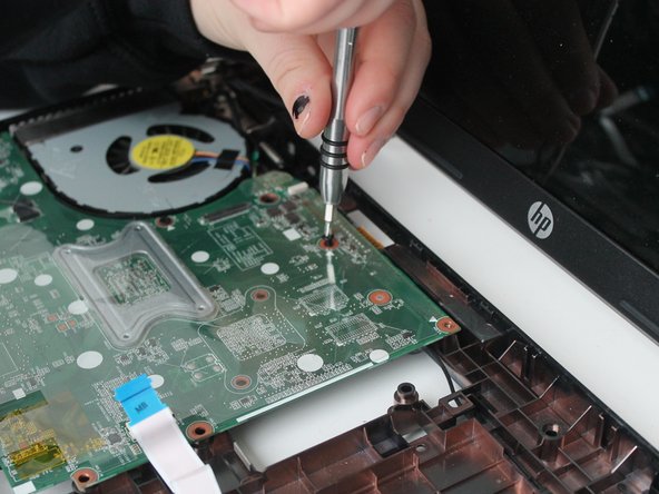

    • Remove the five Phillips PM2.5×5.0 screws on the motherboard.
  23. HP 15-d076nr Charge Port Replacement: crwdns2935265:023crwdnd2935265:01crwdnd2935265:01crwdne2935265:0
    • Remove the Phillips PM2.5×5.0 screw located on the fan, in the upper right corner.

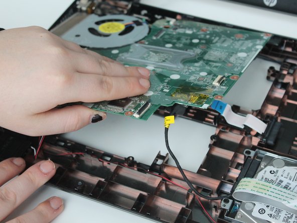

  24. HP 15-d076nr Charge Port Replacement: crwdns2935265:024crwdnd2935265:01crwdnd2935265:02crwdne2935265:0 HP 15-d076nr Charge Port Replacement: crwdns2935265:024crwdnd2935265:02crwdnd2935265:02crwdne2935265:0
    • Carefully lift up the motherboard.
    • Do not completely remove the motherboard. Simply lift it. There is a black cable on the bottom of the motherboard that is anchoring it.
  25. HP 15-d076nr Charge Port Replacement: crwdns2935265:025crwdnd2935265:01crwdnd2935265:01crwdne2935265:0
    • Locate the cable on the underside of the motherboard, in its lower right corner.
    • Carefully grip the cable, and pull downward to remove it.

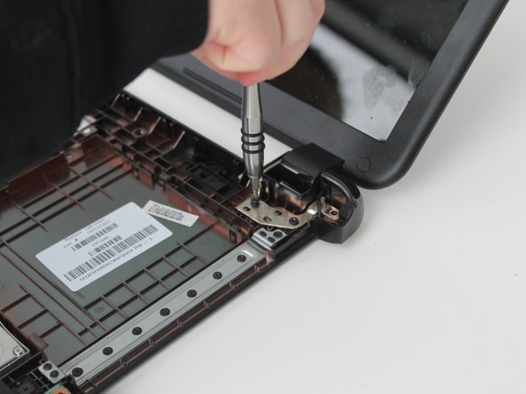

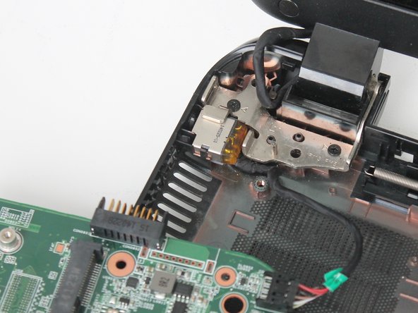

  28. HP 15-d076nr Charge Port Replacement, Charge Port: crwdns2935265:028crwdnd2935265:01crwdnd2935265:03crwdne2935265:0 HP 15-d076nr Charge Port Replacement, Charge Port: crwdns2935265:028crwdnd2935265:02crwdnd2935265:03crwdne2935265:0 HP 15-d076nr Charge Port Replacement, Charge Port: crwdns2935265:028crwdnd2935265:03crwdnd2935265:03crwdne2935265:0
    • Unscrew the two screws located in the upper left corner, and the three screws in the upper right, on the metal hinges of the monitor.
    • This step will disconnect the monitor. Make sure the monitor does not fall or become damaged.

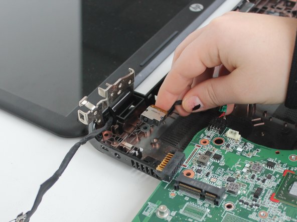

  29. HP 15-d076nr Charge Port Replacement: crwdns2935265:029crwdnd2935265:01crwdnd2935265:01crwdne2935265:0
    • Carefully lay the monitor down flat.
  30. HP 15-d076nr Charge Port Replacement: crwdns2935265:030crwdnd2935265:01crwdnd2935265:02crwdne2935265:0 HP 15-d076nr Charge Port Replacement: crwdns2935265:030crwdnd2935265:02crwdnd2935265:02crwdne2935265:0
    • Pull the charge port away from the body of the laptop.
