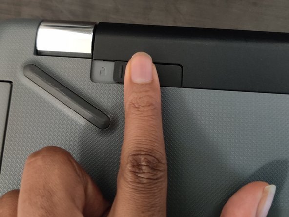

    • Place a finger on the top left slider, then push the black piece all the way to the right.
    • A finger grip to slide the hinge lock open lies to the left of a closed padlock symbol. This is how the battery is unlocked or locked in place.

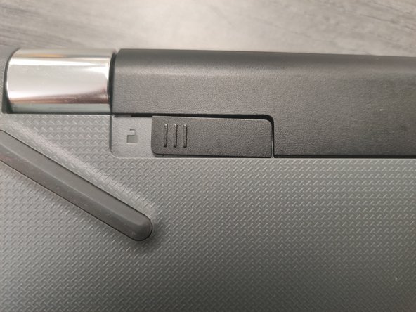

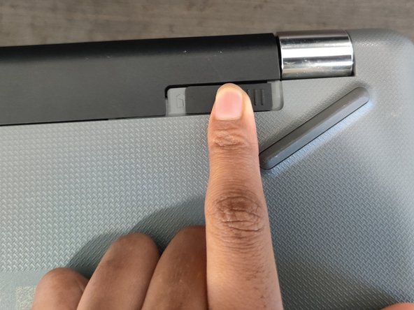

    • Place a finger on the top right slider, then slide the black piece all the way to the left until it clicks out of place.
    • There will be three vertically parallel finger grips on the slider and a small 3/4 full battery symbol to the left of the slider. This slider is what detaches the battery from the laptop.
    • You may need to use a thumb or a little force to complete this step.
