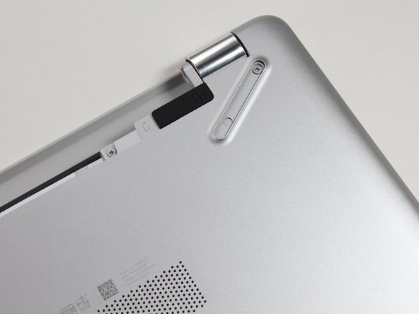

  2. HP 15-bs080wm Hard Drive Replacement: crwdns2935265:02crwdnd2935265:01crwdnd2935265:03crwdne2935265:0 HP 15-bs080wm Hard Drive Replacement: crwdns2935265:02crwdnd2935265:02crwdnd2935265:03crwdne2935265:0 HP 15-bs080wm Hard Drive Replacement: crwdns2935265:02crwdnd2935265:03crwdnd2935265:03crwdne2935265:0
    • Slide the battery lock to the unlock position..
    • Slide the battery release inwards to remove the battery.

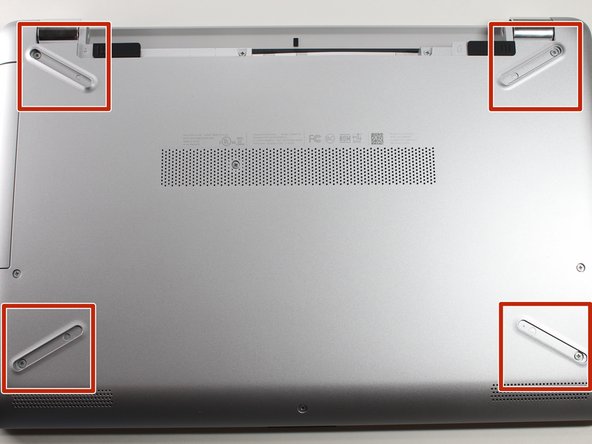

    • Use the plastic opening tool to remove the four rubber feet.

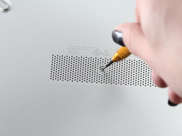

  4. HP 15-bs080wm Hard Drive Replacement: crwdns2935265:04crwdnd2935265:01crwdnd2935265:03crwdne2935265:0 HP 15-bs080wm Hard Drive Replacement: crwdns2935265:04crwdnd2935265:02crwdnd2935265:03crwdne2935265:0 HP 15-bs080wm Hard Drive Replacement: crwdns2935265:04crwdnd2935265:03crwdnd2935265:03crwdne2935265:0

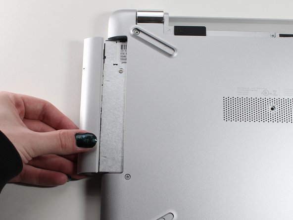

    • Remove the center screw from the back of the laptop using a Phillips #000 screwdriver.
    • Remove the optical drive.

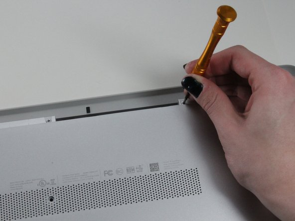

  5. HP 15-bs080wm Hard Drive Replacement: crwdns2935265:05crwdnd2935265:01crwdnd2935265:03crwdne2935265:0 HP 15-bs080wm Hard Drive Replacement: crwdns2935265:05crwdnd2935265:02crwdnd2935265:03crwdne2935265:0 HP 15-bs080wm Hard Drive Replacement: crwdns2935265:05crwdnd2935265:03crwdnd2935265:03crwdne2935265:0

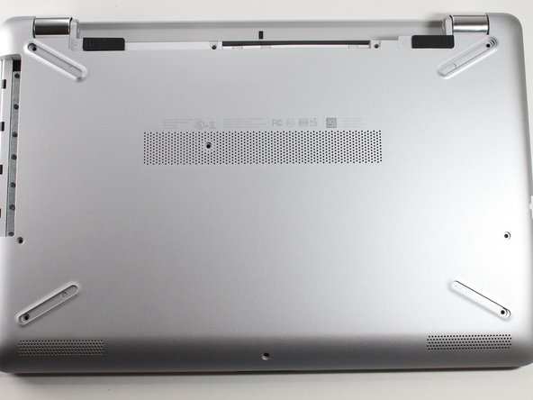

    • Remove the nine screws from the back of the laptop using a Phillips #000 screwdriver.

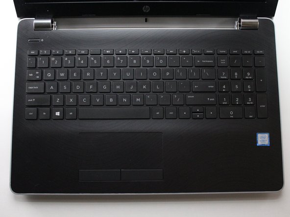

  6. HP 15-bs080wm Hard Drive Replacement: crwdns2935265:06crwdnd2935265:01crwdnd2935265:03crwdne2935265:0 HP 15-bs080wm Hard Drive Replacement: crwdns2935265:06crwdnd2935265:02crwdnd2935265:03crwdne2935265:0 HP 15-bs080wm Hard Drive Replacement: crwdns2935265:06crwdnd2935265:03crwdnd2935265:03crwdne2935265:0
    • Use the plastic opening tool to wedge the back plate from the body of the laptop.
    • Flip the laptop over and remove the back plate.
    • Use the opening tool around the entire perimeter of the laptop's base.

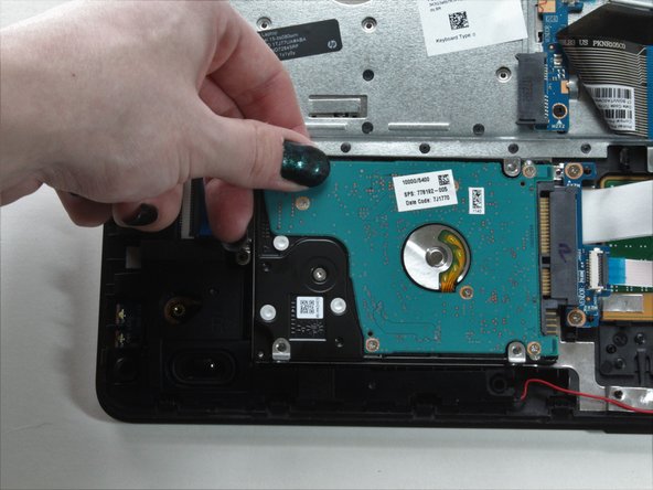

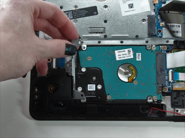

  7. HP 15-bs080wm Hard Drive Replacement: crwdns2935265:07crwdnd2935265:01crwdnd2935265:03crwdne2935265:0 HP 15-bs080wm Hard Drive Replacement: crwdns2935265:07crwdnd2935265:02crwdnd2935265:03crwdne2935265:0 HP 15-bs080wm Hard Drive Replacement: crwdns2935265:07crwdnd2935265:03crwdnd2935265:03crwdne2935265:0
    • Remove the three screws from the hard drive bracket using a Phillips #000 screwdriver.
    • Remove the bracket.
    • Slide the hard drive the left to remove it from the socket.
