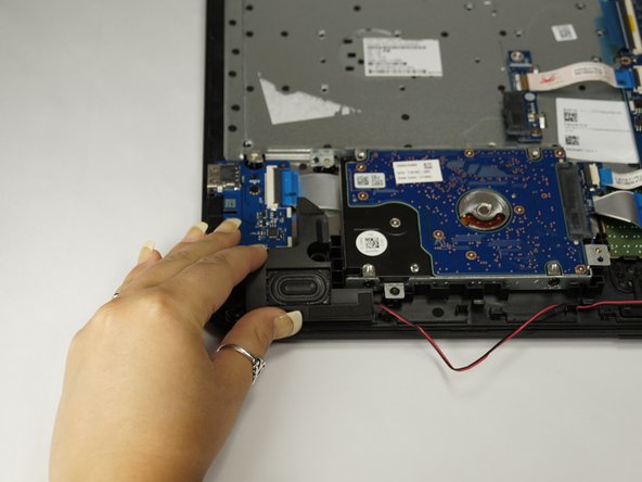

  9. HP 15-ba0709dx Speakers Replacement, Speakers: crwdns2935265:09crwdnd2935265:01crwdnd2935265:02crwdne2935265:0 HP 15-ba0709dx Speakers Replacement, Speakers: crwdns2935265:09crwdnd2935265:02crwdnd2935265:02crwdne2935265:0
    • Locate the speakers on the right and left on the bottom on the back of the device.
  10. HP 15-ba0709dx Speakers Replacement: crwdns2935265:010crwdnd2935265:01crwdnd2935265:01crwdne2935265:0
    • Pull up on the left speaker to pop it off.
    • Do the same on the right speaker to pop it off.
  11. HP 15-ba0709dx Speakers Replacement: crwdns2935265:011crwdnd2935265:01crwdnd2935265:02crwdne2935265:0 HP 15-ba0709dx Speakers Replacement: crwdns2935265:011crwdnd2935265:02crwdnd2935265:02crwdne2935265:0
    • Pull out the speaker outlet.
    • Caution: Be careful not to damage cords while doing so.
