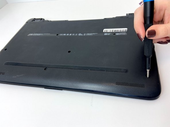

  4. HP 15-ay114cy Speakers Replacement, Unscrew the Back Cover: crwdns2935265:04crwdnd2935265:01crwdnd2935265:02crwdne2935265:0 HP 15-ay114cy Speakers Replacement, Unscrew the Back Cover: crwdns2935265:04crwdnd2935265:02crwdnd2935265:02crwdne2935265:0
    • Use a Phillips #0 screwdriver to remove the 8 mm Phillips-head screws that are holding on the bottom cover of the Laptop.

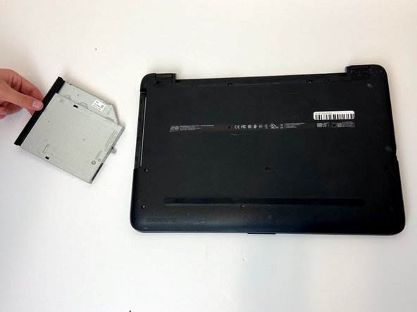

  5. HP 15-ay114cy Speakers Replacement, Remove the Disk Drive: crwdns2935265:05crwdnd2935265:01crwdnd2935265:02crwdne2935265:0 HP 15-ay114cy Speakers Replacement, Remove the Disk Drive: crwdns2935265:05crwdnd2935265:02crwdnd2935265:02crwdne2935265:0
    • Grab a hold of the disk drive and carefully pull it away from the computer.
    • Continue to slide the disk drive out of the laptop until fully removed.
    • Due to the removal of the battery, no power is available to open the disk drive through the use of the eject button.
    • Make sure to pull out the disk drive at a 90 degree angle as demonstrated. Do not attempt to wiggle the drive out of the laptop.
    • There will be resistance when removing the drive. Mishandling may cause broken wires, which could make your disk drive inoperative.

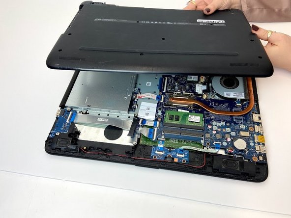

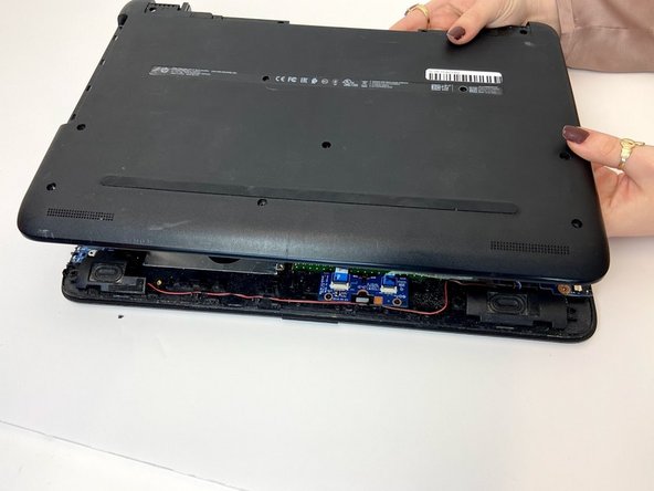

  6. HP 15-ay114cy Speakers Replacement, Remove the Back Cover: crwdns2935265:06crwdnd2935265:01crwdnd2935265:03crwdne2935265:0 HP 15-ay114cy Speakers Replacement, Remove the Back Cover: crwdns2935265:06crwdnd2935265:02crwdnd2935265:03crwdne2935265:0 HP 15-ay114cy Speakers Replacement, Remove the Back Cover: crwdns2935265:06crwdnd2935265:03crwdnd2935265:03crwdne2935265:0
    • Place a plastic opening tool in-between the upper and lower pieces of the bottom cover.
    • Using your hands and the plastic opening tool, gently separate the cover from the frame.
    • Slowly remove the bottom cover from the base of the laptop.
    • Using metal pry tools can damage your device.

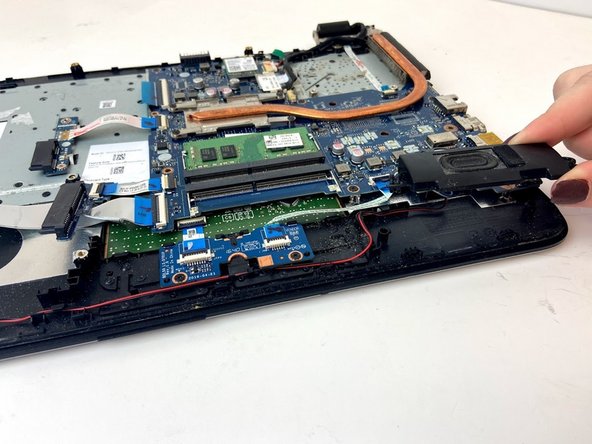

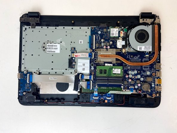

  7. HP 15-ay114cy Speakers Replacement, Remove the Speakers: crwdns2935265:07crwdnd2935265:01crwdnd2935265:03crwdne2935265:0 HP 15-ay114cy Speakers Replacement, Remove the Speakers: crwdns2935265:07crwdnd2935265:02crwdnd2935265:03crwdne2935265:0 HP 15-ay114cy Speakers Replacement, Remove the Speakers: crwdns2935265:07crwdnd2935265:03crwdnd2935265:03crwdne2935265:0
    • Using your index finger and thumb, lift the right speaker to remove it from its housing. This will give enough room to pull the wiring harness from the adapter.
    • Follow the connected wire to the harness.

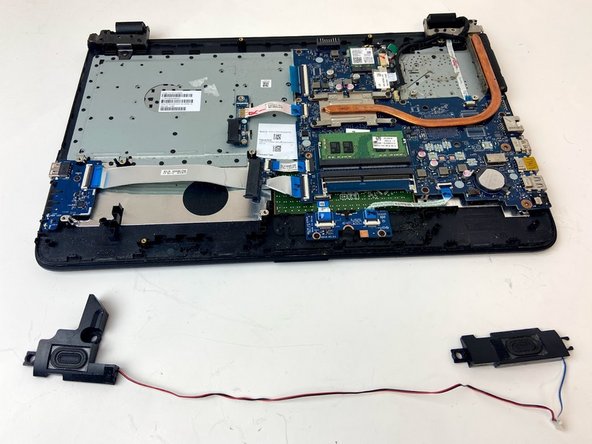

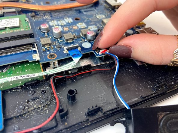

  8. HP 15-ay114cy Speakers Replacement, Insert the Replacement Speakers: crwdns2935265:08crwdnd2935265:01crwdnd2935265:03crwdne2935265:0 HP 15-ay114cy Speakers Replacement, Insert the Replacement Speakers: crwdns2935265:08crwdnd2935265:02crwdnd2935265:03crwdne2935265:0 HP 15-ay114cy Speakers Replacement, Insert the Replacement Speakers: crwdns2935265:08crwdnd2935265:03crwdnd2935265:03crwdne2935265:0
    • Grabbing the base of the wiring harness, use a bit of force to separate the harness from the motherboard adapter.
    • Lift up the old speakers and remove the wiring from the plastic routing tabs.
