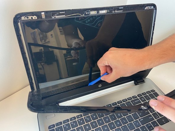

  4. HP 15-ay114cy Screen Replacement, Remove the Plastic Frame: crwdns2935265:04crwdnd2935265:01crwdnd2935265:02crwdne2935265:0 HP 15-ay114cy Screen Replacement, Remove the Plastic Frame: crwdns2935265:04crwdnd2935265:02crwdnd2935265:02crwdne2935265:0
    • Insert the flat end of the plastic opening tool between the screen and plastic frame.
    • Use the plastic opening tool to carefully pry the plastic frame off of the screen, starting in the middle and moving towards the corners.

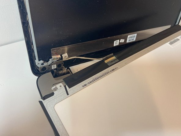

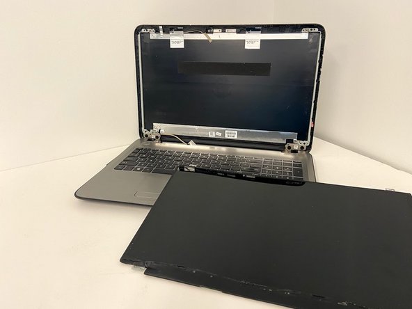

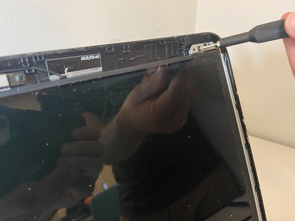

  5. HP 15-ay114cy Screen Replacement, Remove the Screen: crwdns2935265:05crwdnd2935265:01crwdnd2935265:03crwdne2935265:0 HP 15-ay114cy Screen Replacement, Remove the Screen: crwdns2935265:05crwdnd2935265:02crwdnd2935265:03crwdne2935265:0 HP 15-ay114cy Screen Replacement, Remove the Screen: crwdns2935265:05crwdnd2935265:03crwdnd2935265:03crwdne2935265:0
    • Use the #00 Phillips-head screwdriver to remove the four 3 mm screws in each corner and carefully detach the screen and lay it onto the keyboard.

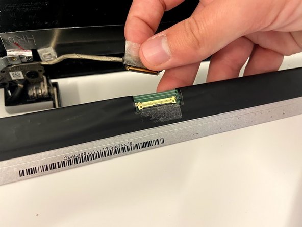

  6. HP 15-ay114cy Screen Replacement, Remove the Metal Display Connector: crwdns2935265:06crwdnd2935265:01crwdnd2935265:03crwdne2935265:0 HP 15-ay114cy Screen Replacement, Remove the Metal Display Connector: crwdns2935265:06crwdnd2935265:02crwdnd2935265:03crwdne2935265:0 HP 15-ay114cy Screen Replacement, Remove the Metal Display Connector: crwdns2935265:06crwdnd2935265:03crwdnd2935265:03crwdne2935265:0
    • Use your thumb and pointer finger to cautiously remove the display connector from the metal frame.
