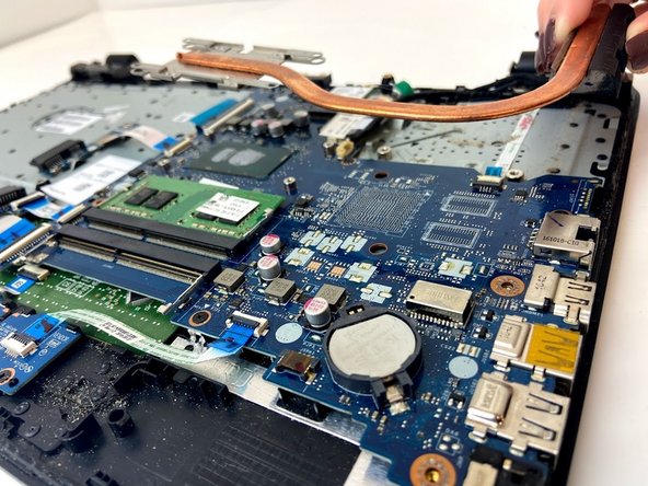

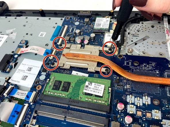

  10. HP 15-ay114cy Motherboard Replacement, Remove the Heatsink: crwdns2935265:010crwdnd2935265:01crwdnd2935265:03crwdne2935265:0 HP 15-ay114cy Motherboard Replacement, Remove the Heatsink: crwdns2935265:010crwdnd2935265:02crwdnd2935265:03crwdne2935265:0 HP 15-ay114cy Motherboard Replacement, Remove the Heatsink: crwdns2935265:010crwdnd2935265:03crwdnd2935265:03crwdne2935265:0
    • Using the Phillips #0 screwdriver, unscrew the four 2 mm Phillips-head screws that secure the heatsink to the laptop base.
    • Grasp one end of the heatsink and then carefully lift up to remove it from the laptop base.

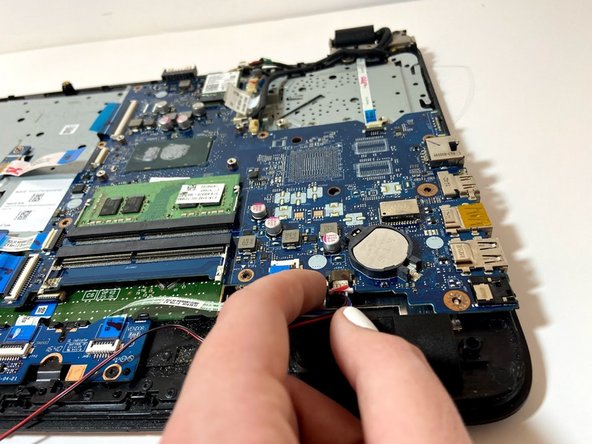

  11. HP 15-ay114cy Motherboard Replacement, Remove the Speaker Wire Connection: crwdns2935265:011crwdnd2935265:01crwdnd2935265:03crwdne2935265:0 HP 15-ay114cy Motherboard Replacement, Remove the Speaker Wire Connection: crwdns2935265:011crwdnd2935265:02crwdnd2935265:03crwdne2935265:0 HP 15-ay114cy Motherboard Replacement, Remove the Speaker Wire Connection: crwdns2935265:011crwdnd2935265:03crwdnd2935265:03crwdne2935265:0
    • Using your index finger and thumb, gently grasp the speaker cable and pull it from the connector.
    • Move along the speaker wire and ensure that none of the wiring is caught on other components or mounting tabs.
    • Remove the speakers.

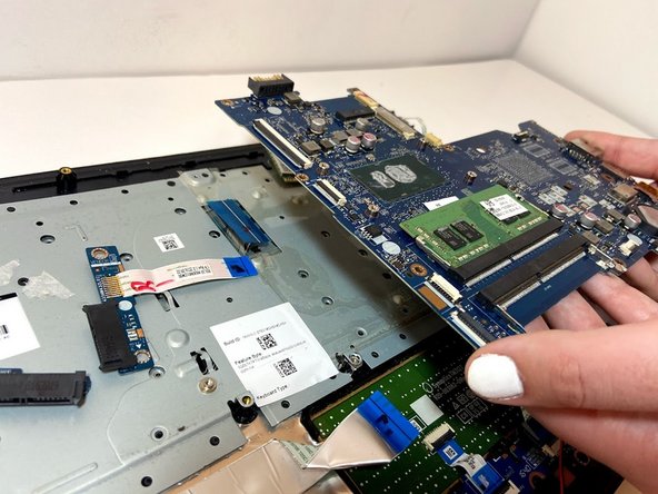

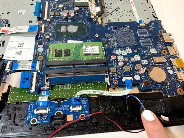

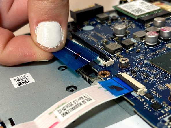

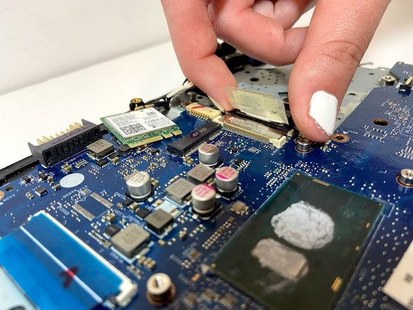

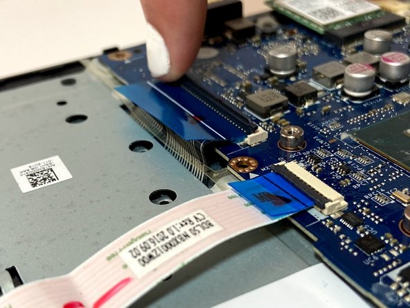

  12. HP 15-ay114cy Motherboard Replacement, Remove the Wired Connections: crwdns2935265:012crwdnd2935265:01crwdnd2935265:03crwdne2935265:0 HP 15-ay114cy Motherboard Replacement, Remove the Wired Connections: crwdns2935265:012crwdnd2935265:02crwdnd2935265:03crwdne2935265:0 HP 15-ay114cy Motherboard Replacement, Remove the Wired Connections: crwdns2935265:012crwdnd2935265:03crwdnd2935265:03crwdne2935265:0
    • Place your index finger on the plastic ridge of each of the seven ZIF connectors connected to the motherboard.
    • Using your index finger, flip up the black tabs on each of the connectors to release the cable.
    • Gently pull each the wired connections from the motherboard.

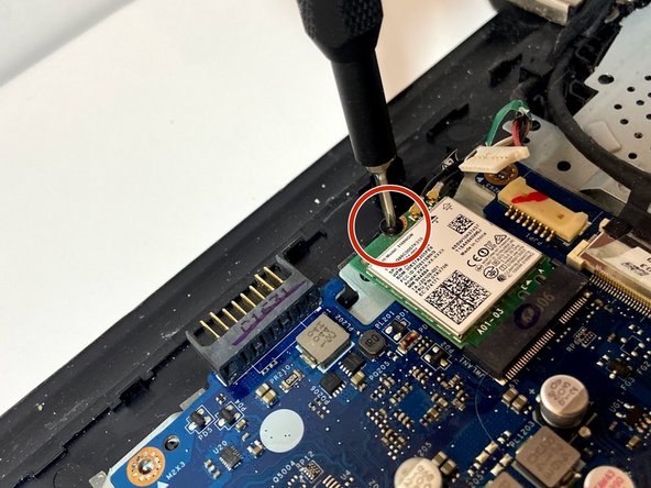

  13. HP 15-ay114cy Motherboard Replacement, Remove the Screws from the Base: crwdns2935265:013crwdnd2935265:01crwdnd2935265:02crwdne2935265:0 HP 15-ay114cy Motherboard Replacement, Remove the Screws from the Base: crwdns2935265:013crwdnd2935265:02crwdnd2935265:02crwdne2935265:0
    • Using a Phillips #0 screwdriver, unscrew the twelve 2 mm Phillips-head screws that secure the motherboard to the laptop base.

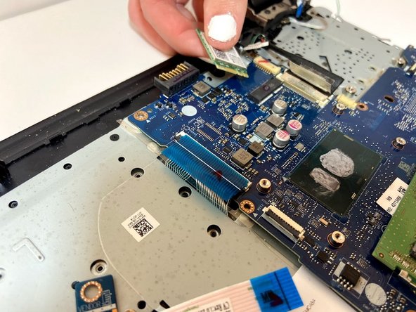

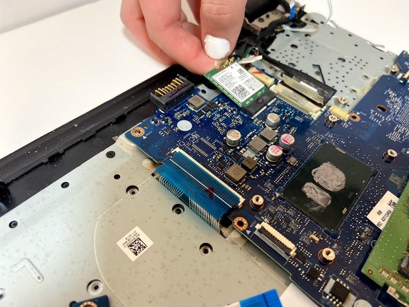

  14. HP 15-ay114cy Motherboard Replacement, Remove the Wireless Card: crwdns2935265:014crwdnd2935265:01crwdnd2935265:03crwdne2935265:0 HP 15-ay114cy Motherboard Replacement, Remove the Wireless Card: crwdns2935265:014crwdnd2935265:02crwdnd2935265:03crwdne2935265:0 HP 15-ay114cy Motherboard Replacement, Remove the Wireless Card: crwdns2935265:014crwdnd2935265:03crwdnd2935265:03crwdne2935265:0
    • Use your index finger and thumb to gently grasp the green wireless card, then pull the card horizontally out and away from the motherboard.
  15. HP 15-ay114cy Motherboard Replacement, Remove the Audio/USB Board: crwdns2935265:015crwdnd2935265:01crwdnd2935265:03crwdne2935265:0 HP 15-ay114cy Motherboard Replacement, Remove the Audio/USB Board: crwdns2935265:015crwdnd2935265:02crwdnd2935265:03crwdne2935265:0 HP 15-ay114cy Motherboard Replacement, Remove the Audio/USB Board: crwdns2935265:015crwdnd2935265:03crwdnd2935265:03crwdne2935265:0
    • Use your index finger and thumb to gently grasp the display connector and remove it from the motherboard.
    • Carefully grasp an end of the motherboard and gradually lift it up and away from the laptop.
