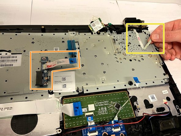

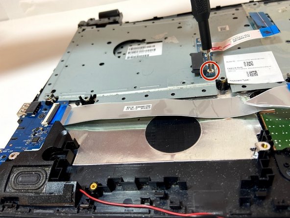

    • Unscrew the silver 2 mm Phillips #0 screw holding on the blue circuit/dock and place it to the side.
    • Gently lift up to remove the blue circuit board from the silver panel.
    • Peel the 3M tape towards the battery compartment to un-stick it from the panel.
    • Note: Check for any other screws which may prevent you from removing the silver panel.

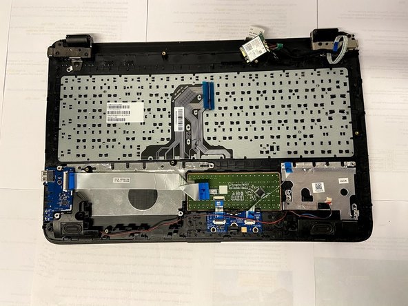

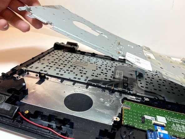

  17. HP 15-ay114cy Keyboard Replacement, Remove the Panel: crwdns2935265:017crwdnd2935265:01crwdnd2935265:03crwdne2935265:0 HP 15-ay114cy Keyboard Replacement, Remove the Panel: crwdns2935265:017crwdnd2935265:02crwdnd2935265:03crwdne2935265:0 HP 15-ay114cy Keyboard Replacement, Remove the Panel: crwdns2935265:017crwdnd2935265:03crwdnd2935265:03crwdne2935265:0
    • Insert the flat end of the metal spudger into one of the panel corners and lift up on the pry tool. This action will separate the panel from the laptop frame.
    • Steadily pry around the edges of the rectangular panel in a clockwise rotation.
    • Lift up the silver panel cover to remove it and place it to the side. This will reveal your keyboard assembly.
    • When using the pry tool to separate the panel, you will hear popping and also will see small plastic bits break off of your device.
    • Due to the likelihood of plastic projectiles, we recommend the use of eye protection when performing this task.
    • Using the metal spudger pry tool may damage your device. Be careful not to put too much pressure on the plastic frame, as it may cause bending and cracking.

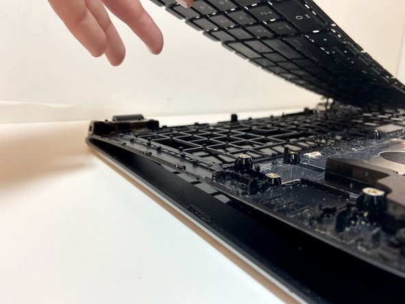

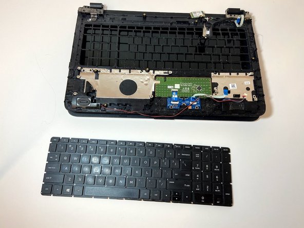

  18. HP 15-ay114cy Keyboard Replacement, Remove the Keyboard: crwdns2935265:018crwdnd2935265:01crwdnd2935265:03crwdne2935265:0 HP 15-ay114cy Keyboard Replacement, Remove the Keyboard: crwdns2935265:018crwdnd2935265:02crwdnd2935265:03crwdne2935265:0 HP 15-ay114cy Keyboard Replacement, Remove the Keyboard: crwdns2935265:018crwdnd2935265:03crwdnd2935265:03crwdne2935265:0
    • Carefully open the laptop and push up on one of the keys. This will allow you to grab the keyboard from the edge and remove the keyboard assembly from the device.
