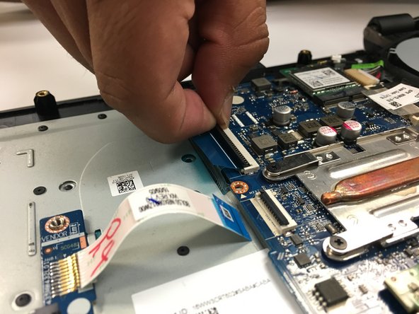

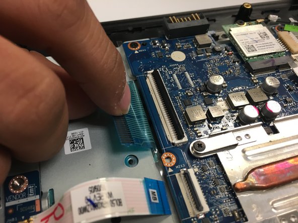

  8. HP 15-ay103dx Motherboard  Replacement, Motherboard: crwdns2935265:08crwdnd2935265:01crwdnd2935265:03crwdne2935265:0 HP 15-ay103dx Motherboard  Replacement, Motherboard: crwdns2935265:08crwdnd2935265:02crwdnd2935265:03crwdne2935265:0 HP 15-ay103dx Motherboard  Replacement, Motherboard: crwdns2935265:08crwdnd2935265:03crwdnd2935265:03crwdne2935265:0
    • Disconnect the wires around the motherboard securing it to the device.
    • To do this, flip the black "switches" securing the wires into place upwards.

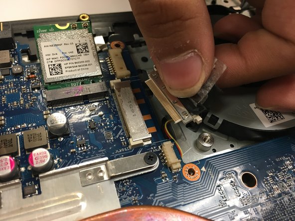

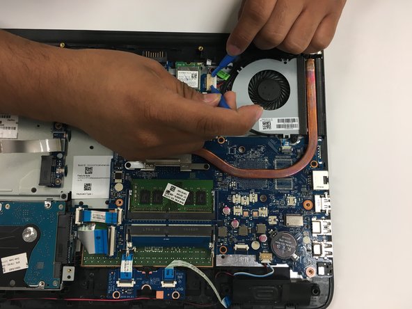

  10. HP 15-ay103dx Motherboard  Replacement: crwdns2935265:010crwdnd2935265:01crwdnd2935265:03crwdne2935265:0 HP 15-ay103dx Motherboard  Replacement: crwdns2935265:010crwdnd2935265:02crwdnd2935265:03crwdne2935265:0 HP 15-ay103dx Motherboard  Replacement: crwdns2935265:010crwdnd2935265:03crwdnd2935265:03crwdne2935265:0
    • Disconnect the wire securing the whole motherboard located at the top to the motherboard.
    • This is possible with your fingers, but is easier to do using an iFixit opening tool.
