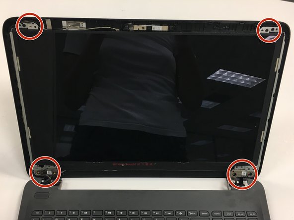

  8. HP 15-ay103dx Display Screen Hinges Replacement, Display Screen Hinges: crwdns2935265:08crwdnd2935265:01crwdnd2935265:02crwdne2935265:0 HP 15-ay103dx Display Screen Hinges Replacement, Display Screen Hinges: crwdns2935265:08crwdnd2935265:02crwdnd2935265:02crwdne2935265:0
    • Use a spudger to carefully remove the border around the display screen.
    • As long as you are slow and delicate, the border will eventually come off.
  9. HP 15-ay103dx Display Screen Hinges Replacement: crwdns2935265:09crwdnd2935265:01crwdnd2935265:02crwdne2935265:0 HP 15-ay103dx Display Screen Hinges Replacement: crwdns2935265:09crwdnd2935265:02crwdnd2935265:02crwdne2935265:0
    • Remove the two 5/16 screws in the top corners and the four in the bottom corners.
  10. HP 15-ay103dx Display Screen Hinges Replacement: crwdns2935265:010crwdnd2935265:01crwdnd2935265:01crwdne2935265:0
    • Carefully pull the screen from the hinges and lower it on to the table.
    • There will be wires running from the screen to the motherboard. You do not need to unplug these.
    • The hinges are made of malleable metal and are easily bent.
  11. HP 15-ay103dx Display Screen Hinges Replacement: crwdns2935265:011crwdnd2935265:01crwdnd2935265:01crwdne2935265:0
    • Remove the 5/16 screws securing the hinges to the computer.
