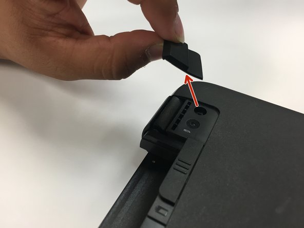

  5. HP 15-ay103dx Back Panel Replacement: crwdns2935265:05crwdnd2935265:01crwdnd2935265:02crwdne2935265:0 HP 15-ay103dx Back Panel Replacement: crwdns2935265:05crwdnd2935265:02crwdnd2935265:02crwdne2935265:0
    • Covering the hinges of the device are rubber bumpers secured to the device using adhesive. Remove them carefully.
    • Place the adhesive side up as you will need to place them back after your replacement is complete.

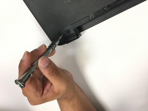

  6. HP 15-ay103dx Back Panel Replacement: crwdns2935265:06crwdnd2935265:01crwdnd2935265:02crwdne2935265:0 HP 15-ay103dx Back Panel Replacement: crwdns2935265:06crwdnd2935265:02crwdnd2935265:02crwdne2935265:0
    • In the same spot you’ve just removed the bumpers from, you will find two 5/16 in. screws. Using the same Phillips-head screwdriver used in step 2, remove the screws
    • Be sure to keep the screws together!
