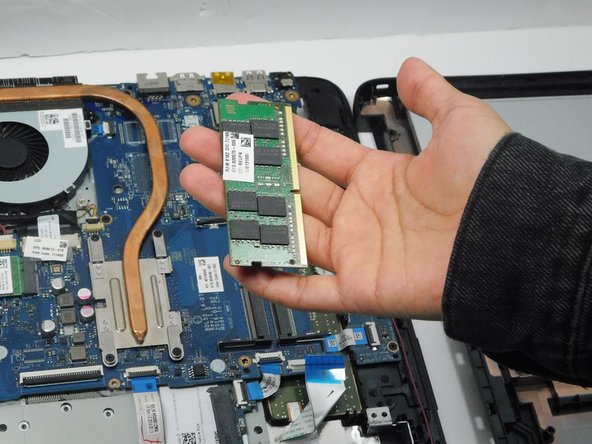

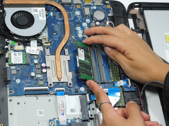

  3. HP 15-ay091ms RAM Replacement, RAM: crwdns2935265:03crwdnd2935265:01crwdnd2935265:03crwdne2935265:0 HP 15-ay091ms RAM Replacement, RAM: crwdns2935265:03crwdnd2935265:02crwdnd2935265:03crwdne2935265:0 HP 15-ay091ms RAM Replacement, RAM: crwdns2935265:03crwdnd2935265:03crwdnd2935265:03crwdne2935265:0
    • Pull the metal brackets holding the RAM in place away from each other.
    • After you hold the brackets apart, the RAM will pop up.
    • Remove the RAM.
