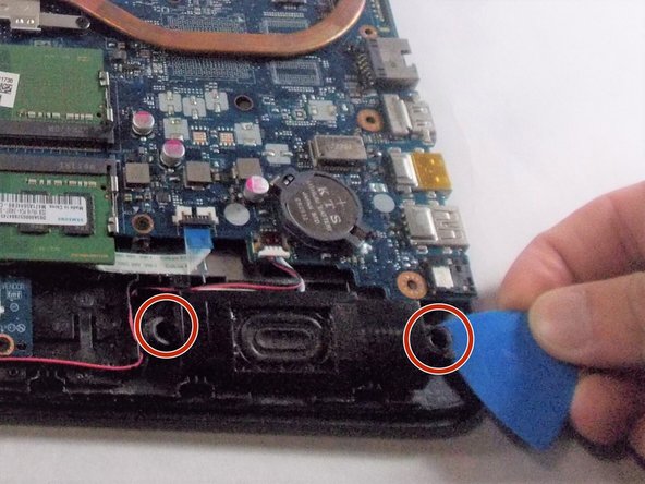

  7. HP 15-ay078nr Speakers Replacement, Speakers: crwdns2935265:07crwdnd2935265:01crwdnd2935265:02crwdne2935265:0 HP 15-ay078nr Speakers Replacement, Speakers: crwdns2935265:07crwdnd2935265:02crwdnd2935265:02crwdne2935265:0
    • The speakers are located in the bottom right and left corners of the device.
    • Use the opening pick to pry up the two plastic clip fasteners.
  8. HP 15-ay078nr Speakers Replacement: crwdns2935265:08crwdnd2935265:01crwdnd2935265:01crwdne2935265:0
    • Pull the cable speaker cable out of its housing on the motherboard.
