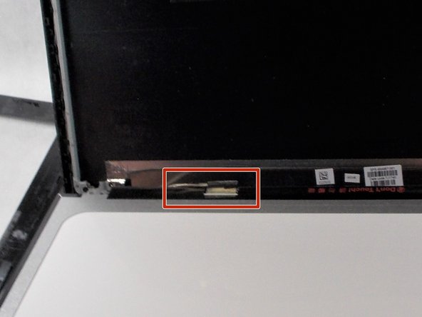

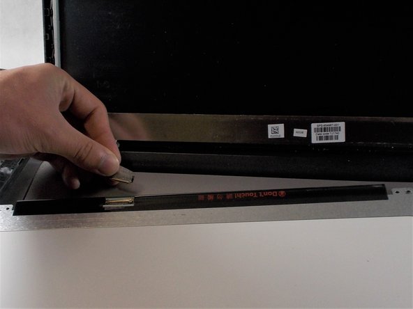

  3. HP 15-ay078nr Screen Replacement: crwdns2935265:03crwdnd2935265:01crwdnd2935265:03crwdne2935265:0 HP 15-ay078nr Screen Replacement: crwdns2935265:03crwdnd2935265:02crwdnd2935265:03crwdne2935265:0 HP 15-ay078nr Screen Replacement: crwdns2935265:03crwdnd2935265:03crwdnd2935265:03crwdne2935265:0
    • Gently lay the screen against the keyboard.
    • Disconnect the display cable from the rest of the laptop.
Power on your device to see the new screen. If the backlight is flickering, the LCD cable may have not been pushed in completely. Ensure it is fully connected.
