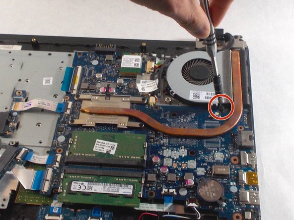

  7. HP 15-ay078nr Fan Replacement, Fan: crwdns2935265:07crwdnd2935265:01crwdnd2935265:01crwdne2935265:0
    • Unplug the fan cable from the connector on the motherboard.
  8. HP 15-ay078nr Fan Replacement: crwdns2935265:08crwdnd2935265:01crwdnd2935265:02crwdne2935265:0 HP 15-ay078nr Fan Replacement: crwdns2935265:08crwdnd2935265:02crwdnd2935265:02crwdne2935265:0
    • Remove two 3.4 mm screws from the fan using a Phillips #2 screwdriver.
  9. HP 15-ay078nr Fan Replacement: crwdns2935265:09crwdnd2935265:01crwdnd2935265:01crwdne2935265:0
    • Lift up and remove the fan from the laptop.
