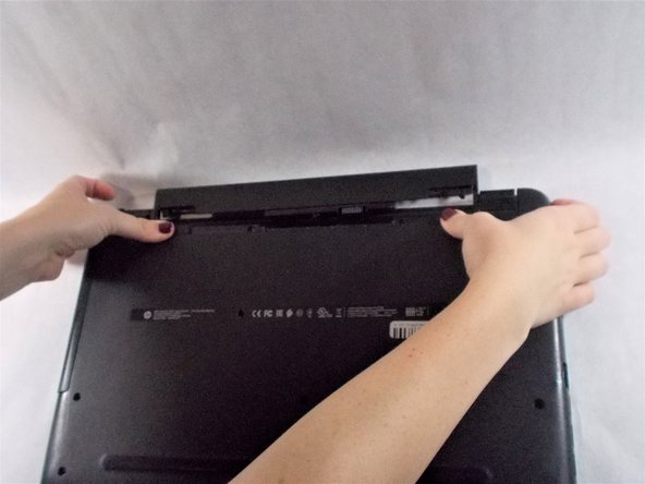

    • Put your fingers on the battery latch.
  3. HP 15-ay078nr Back Panel Replacement: crwdns2935265:03crwdnd2935265:01crwdnd2935265:02crwdne2935265:0 HP 15-ay078nr Back Panel Replacement: crwdns2935265:03crwdnd2935265:02crwdnd2935265:02crwdne2935265:0
    • Using your fingers, push each battery latch simultaneously towards the middle.
    • This releases the battery.
    • Remove the battery from the laptop.

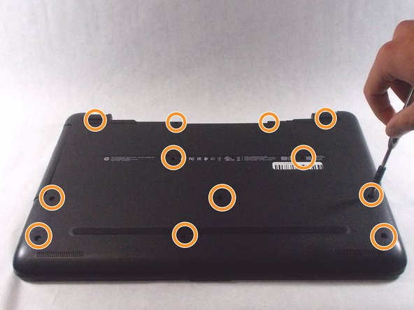

  4. HP 15-ay078nr Back Panel Replacement, Back Panel: crwdns2935265:04crwdnd2935265:01crwdnd2935265:02crwdne2935265:0 HP 15-ay078nr Back Panel Replacement, Back Panel: crwdns2935265:04crwdnd2935265:02crwdnd2935265:02crwdne2935265:0
    • Pull off the two rubber feet on the underside of the device.
    • Remove the twelve 9.5 mm screws from the underside of the device using a Phillips #2 screwdriver.
