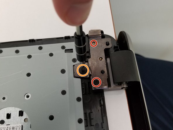

    • Remove the display by unscrewing the four 3mm JIS #0 screws.
    • Remove one 2mm JIS #0 screw.

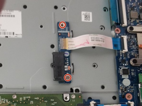

    • Unscrew the two 3mm JIS #0 screws that hold the optical drive (CD-reader) connection to the device.
  28. HP 15-ay052nr Keyboard and Touchpad Replacement: crwdns2935265:028crwdnd2935265:01crwdnd2935265:02crwdne2935265:0 HP 15-ay052nr Keyboard and Touchpad Replacement: crwdns2935265:028crwdnd2935265:02crwdnd2935265:02crwdne2935265:0

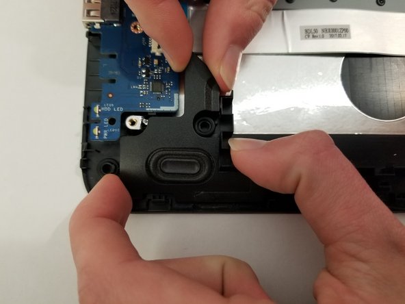

    • Remove the two (2) speakers located on the botten edge of the keyboard cover.
    • Along the edge that the touch-pad board and hard drive is located.
