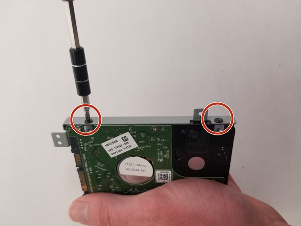

  10. HP 15-ay052nr Hard Disk Drive Replacement: crwdns2935265:010crwdnd2935265:01crwdnd2935265:02crwdne2935265:0 HP 15-ay052nr Hard Disk Drive Replacement: crwdns2935265:010crwdnd2935265:02crwdnd2935265:02crwdne2935265:0
    • Lift the hard drive from the computer and remove the two 3-mm screws that connect each mounting bracket to the hard drive.
