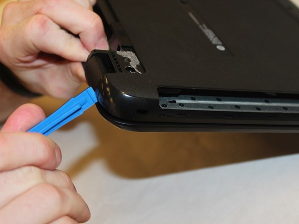

    • Remove the 11 screws holding the body of the laptop together with a size #00 Phillips screwdriver.
  7. HP 15-ay014dx Motherboard Replacement: crwdns2935265:07crwdnd2935265:01crwdnd2935265:02crwdne2935265:0 HP 15-ay014dx Motherboard Replacement: crwdns2935265:07crwdnd2935265:02crwdnd2935265:02crwdne2935265:0
    • Use the spudger to press the tabs in the back of the computer. Carefully remove the back of the laptop by prying around the sides using the plastic opening tool.

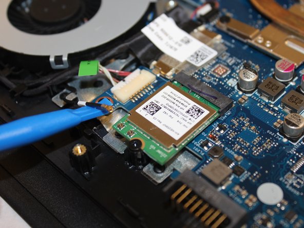

  15. HP 15-ay014dx Motherboard Replacement, Wireless Card: crwdns2935265:015crwdnd2935265:01crwdnd2935265:01crwdne2935265:0
  16. HP 15-ay014dx Motherboard Replacement: crwdns2935265:016crwdnd2935265:01crwdnd2935265:02crwdne2935265:0 HP 15-ay014dx Motherboard Replacement: crwdns2935265:016crwdnd2935265:02crwdnd2935265:02crwdne2935265:0
    • Using the spudger, push in the tabs in the back that hold the body together. Carefully pry the body apart by working the spudger around the body.
  17. HP 15-ay014dx Motherboard Replacement: crwdns2935265:017crwdnd2935265:01crwdnd2935265:02crwdne2935265:0 HP 15-ay014dx Motherboard Replacement: crwdns2935265:017crwdnd2935265:02crwdnd2935265:02crwdne2935265:0
    • Using the spudger, carefully pry the wire connecting the wireless card to the motherboard off of it.
  18. HP 15-ay014dx Motherboard Replacement: crwdns2935265:018crwdnd2935265:01crwdnd2935265:01crwdne2935265:0
    • Using the size #00 Phillips screwdriver remove the single screw holding it in place.
  19. HP 15-ay014dx Motherboard Replacement: crwdns2935265:019crwdnd2935265:01crwdnd2935265:01crwdne2935265:0
    • carefully pull the card of its slot.
  20. HP 15-ay014dx Motherboard Replacement, Motherboard: crwdns2935265:020crwdnd2935265:01crwdnd2935265:03crwdne2935265:0 HP 15-ay014dx Motherboard Replacement, Motherboard: crwdns2935265:020crwdnd2935265:02crwdnd2935265:03crwdne2935265:0 HP 15-ay014dx Motherboard Replacement, Motherboard: crwdns2935265:020crwdnd2935265:03crwdnd2935265:03crwdne2935265:0

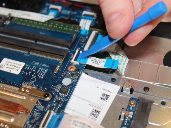

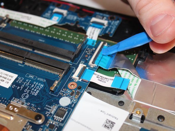

    • Disconnect all ribbon connectors by flipping up the black tabs and gently pulling them out.
    • Disconnect​ ​the​ ​speakers​ ​by​ ​gently ​pulling​​ ​the​ ​connector ​out.
    • Disconnect​ ​the​ ​Fan​ ​by​ ​gently ​pulling​​ ​the​ ​connector​ ​out.
    • Disconnect the power by gently pulling the connectors out.
