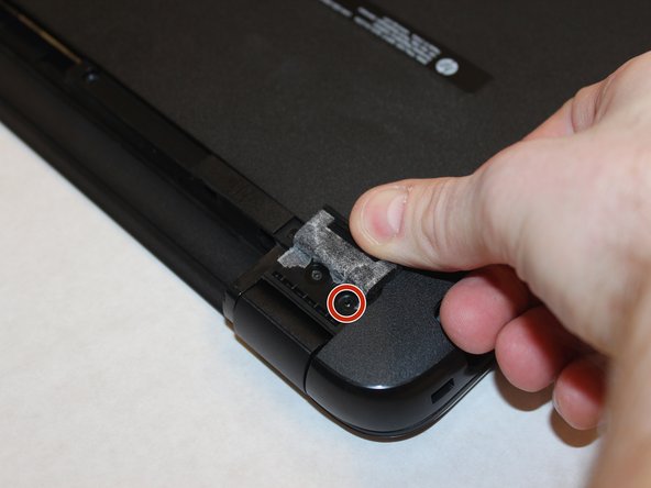

  4. HP 15-ay014dx Hard Drive Disk Replacement, Optical Drive: crwdns2935265:04crwdnd2935265:01crwdnd2935265:01crwdne2935265:0
    • Close the laptop and lay it down with the bottom facing up.
    • Using a size #00 Phillips screw drive remove the screw holding in the optical drive.
  5. HP 15-ay014dx Hard Drive Disk Replacement: crwdns2935265:05crwdnd2935265:01crwdnd2935265:01crwdne2935265:0
    • Grip the optical drive and gently pull it out.

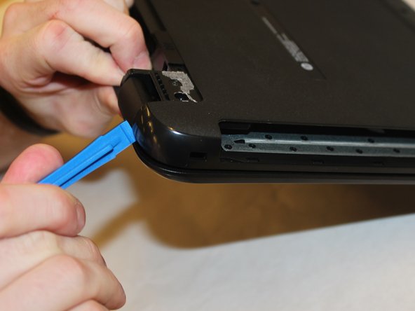

    • Remove the highlighted screws holding the body of the laptop together with a size #00 Phillips screwdriver.
  7. HP 15-ay014dx Hard Drive Disk Replacement: crwdns2935265:07crwdnd2935265:01crwdnd2935265:03crwdne2935265:0 HP 15-ay014dx Hard Drive Disk Replacement: crwdns2935265:07crwdnd2935265:02crwdnd2935265:03crwdne2935265:0 HP 15-ay014dx Hard Drive Disk Replacement: crwdns2935265:07crwdnd2935265:03crwdnd2935265:03crwdne2935265:0
    • Using the spudger, push in the tabs in the back that hold the body together. Carefully pry the body apart by working the spudger around the body.
    • Pull the back cover off.

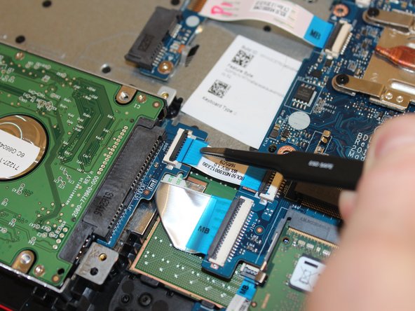

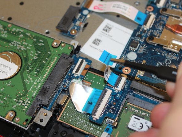

  8. HP 15-ay014dx Hard Drive Disk Replacement: crwdns2935265:08crwdnd2935265:01crwdnd2935265:03crwdne2935265:0 HP 15-ay014dx Hard Drive Disk Replacement: crwdns2935265:08crwdnd2935265:02crwdnd2935265:03crwdne2935265:0 HP 15-ay014dx Hard Drive Disk Replacement: crwdns2935265:08crwdnd2935265:03crwdnd2935265:03crwdne2935265:0
    • Pry up on the clamp holding the SATA power ribbon using the plastic opening tool.
    • Pull out the SATA power ribbon using the tweezers.

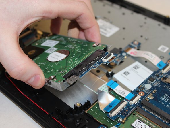

  9. HP 15-ay014dx Hard Drive Disk Replacement: crwdns2935265:09crwdnd2935265:01crwdnd2935265:02crwdne2935265:0 HP 15-ay014dx Hard Drive Disk Replacement: crwdns2935265:09crwdnd2935265:02crwdnd2935265:02crwdne2935265:0
    • Remove the highlighted screws holding the hard drive to the body using the Philips #00 screwdriver.
    • Remove the hard drive.
  10. HP 15-ay014dx Hard Drive Disk Replacement: crwdns2935265:010crwdnd2935265:01crwdnd2935265:01crwdne2935265:0
    • Remove the 4 screws holding the hard drive to the hard drive cage using the Philips #00 screwdriver.
