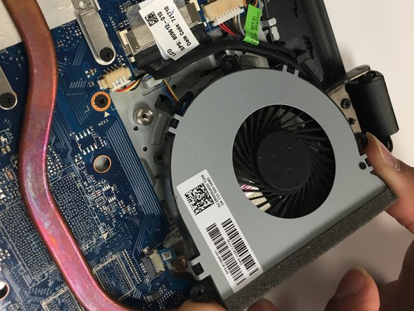

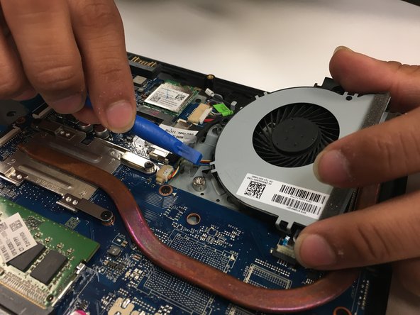

  9. HP 15-ay011nr Fan Replacement: crwdns2935265:09crwdnd2935265:01crwdnd2935265:02crwdne2935265:0 HP 15-ay011nr Fan Replacement: crwdns2935265:09crwdnd2935265:02crwdnd2935265:02crwdne2935265:0
    • Lift the clear plastic strip holding down the fan and lift the fan out of place.
  10. HP 15-ay011nr Fan Replacement: crwdns2935265:010crwdnd2935265:01crwdnd2935265:02crwdne2935265:0 HP 15-ay011nr Fan Replacement: crwdns2935265:010crwdnd2935265:02crwdnd2935265:02crwdne2935265:0
    • Use your fingers or tweezers to pinch both sides of the connector and remove the fan from the device.
