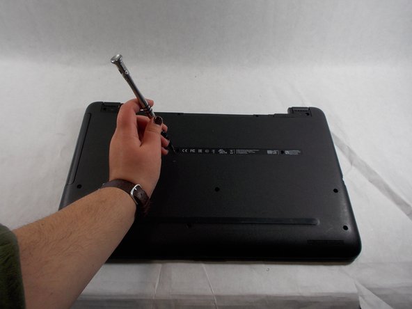

  5. HP 15-af123cl Hard Drive Replacement, Back Cover: crwdns2935265:05crwdnd2935265:01crwdnd2935265:01crwdne2935265:0
    • Remove the twelve screws from the bottom of the laptop using a Phillips #00 screwdriver.

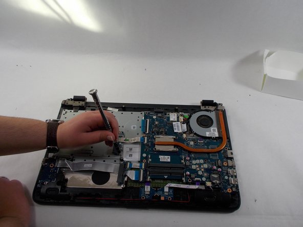

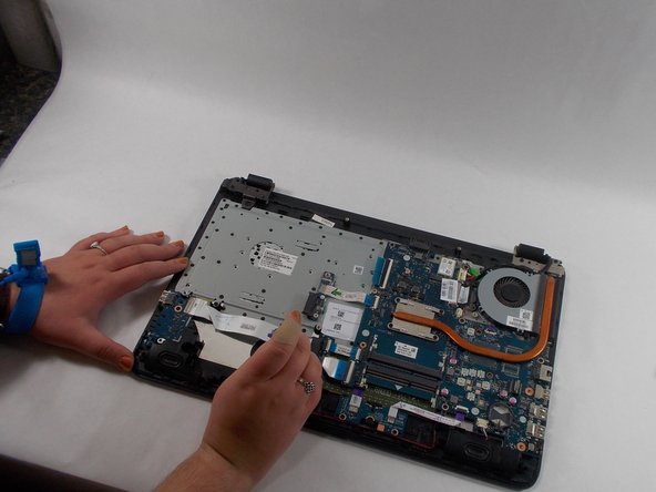

  8. HP 15-af123cl Hard Drive Replacement, Hard Drive: crwdns2935265:08crwdnd2935265:01crwdnd2935265:02crwdne2935265:0 HP 15-af123cl Hard Drive Replacement, Hard Drive: crwdns2935265:08crwdnd2935265:02crwdnd2935265:02crwdne2935265:0
    • Unclip the cable connected to the drive using an opening tool.
  9. HP 15-af123cl Hard Drive Replacement: crwdns2935265:09crwdnd2935265:01crwdnd2935265:03crwdne2935265:0 HP 15-af123cl Hard Drive Replacement: crwdns2935265:09crwdnd2935265:02crwdnd2935265:03crwdne2935265:0 HP 15-af123cl Hard Drive Replacement: crwdns2935265:09crwdnd2935265:03crwdnd2935265:03crwdne2935265:0

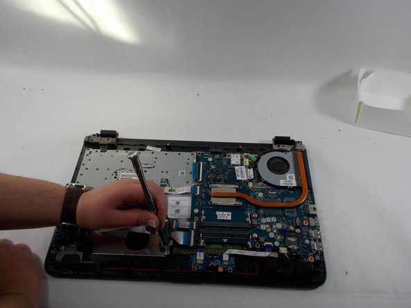

    • Remove the screws from the brackets around the hard drive using a Phillips #00 screwdriver.
  10. HP 15-af123cl Hard Drive Replacement: crwdns2935265:010crwdnd2935265:01crwdnd2935265:01crwdne2935265:0
    • Remove the brackets from around the hard drive.
    • Remove the hard drive from the laptop.
