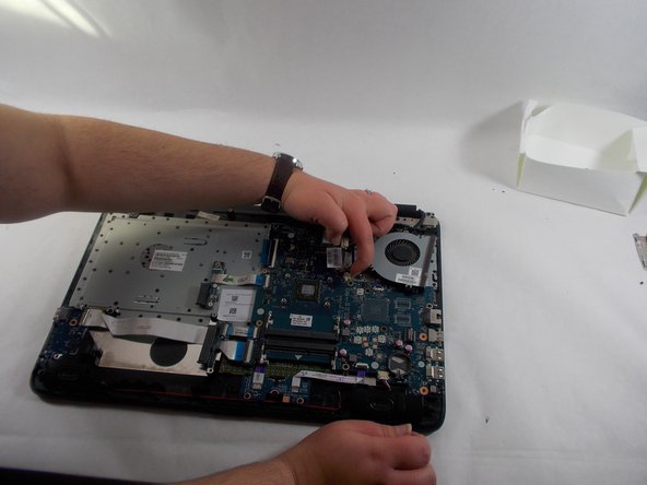

  6. HP 15-af123cl Fan Replacement, Fan: crwdns2935265:06crwdnd2935265:01crwdnd2935265:01crwdne2935265:0
    • Remove all seven screws from the fan and heat sink using a Phillips #000 screwdriver.
  7. HP 15-af123cl Fan Replacement: crwdns2935265:07crwdnd2935265:01crwdnd2935265:01crwdne2935265:0
    • Remove the heat sink from the laptop.
  8. HP 15-af123cl Fan Replacement: crwdns2935265:08crwdnd2935265:01crwdnd2935265:02crwdne2935265:0 HP 15-af123cl Fan Replacement: crwdns2935265:08crwdnd2935265:02crwdnd2935265:02crwdne2935265:0
    • Disconnect the fan cables from the motherboard using an opening tool.
  9. HP 15-af123cl Fan Replacement: crwdns2935265:09crwdnd2935265:01crwdnd2935265:01crwdne2935265:0
    • Remove the fan from the laptop.
