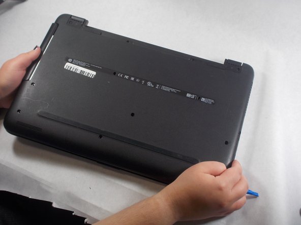

    • Push the slider with a lock symbol to the right to unlock the battery.
  2. HP 15-af123cl Back Cover Replacement: crwdns2935265:02crwdnd2935265:01crwdnd2935265:01crwdne2935265:0
    • Push the slider with a battery symbol to the left to push the battery out slightly.
    • Pull the battery out fully now that it is released.
  3. HP 15-af123cl Back Cover Replacement, Back Cover: crwdns2935265:03crwdnd2935265:01crwdnd2935265:01crwdne2935265:0
    • Remove the twelve screws from the bottom of the laptop using a Phillips #00 screwdriver.

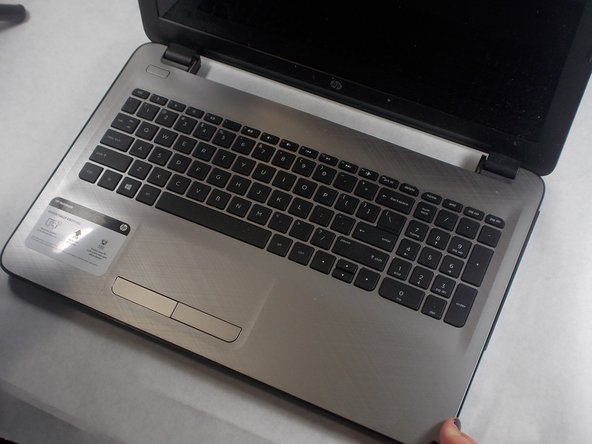

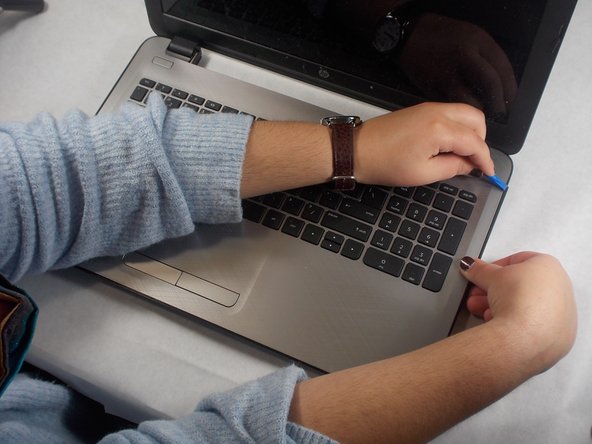

    • Turn the laptop over and open the lid.
    • Use an opening tool to pry the bottom cover from the body of the laptop.
  5. HP 15-af123cl Back Cover Replacement: crwdns2935265:05crwdnd2935265:01crwdnd2935265:02crwdne2935265:0 HP 15-af123cl Back Cover Replacement: crwdns2935265:05crwdnd2935265:02crwdnd2935265:02crwdne2935265:0
    • Close and turn over the laptop again.
    • Pull the back cover up to remove it from the laptop.
