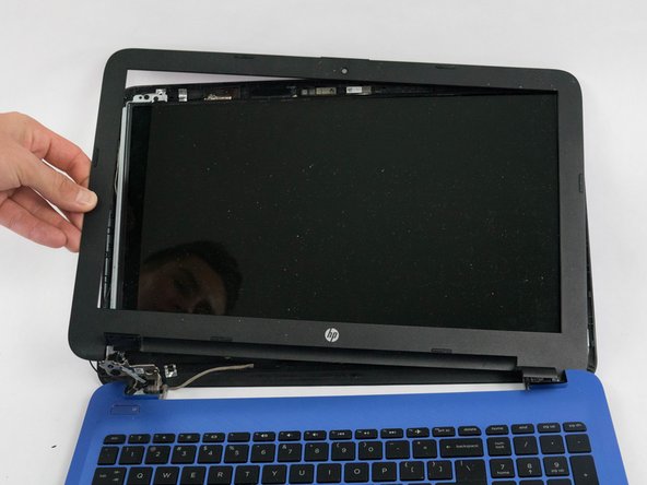

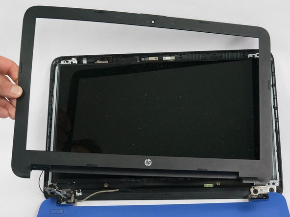

  4. HP 15-af013cl Screen Replacement: crwdns2935265:04crwdnd2935265:01crwdnd2935265:03crwdne2935265:0 HP 15-af013cl Screen Replacement: crwdns2935265:04crwdnd2935265:02crwdnd2935265:03crwdne2935265:0 HP 15-af013cl Screen Replacement: crwdns2935265:04crwdnd2935265:03crwdnd2935265:03crwdne2935265:0
    • Using a pry tool, unclip the entire outer plastic cover from the front of the screen.
    • Gently remove the front plastic cover.

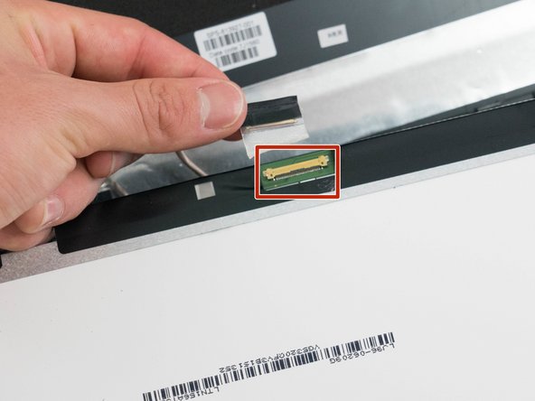

  6. HP 15-af013cl Screen Replacement: crwdns2935265:06crwdnd2935265:01crwdnd2935265:02crwdne2935265:0 HP 15-af013cl Screen Replacement: crwdns2935265:06crwdnd2935265:02crwdnd2935265:02crwdne2935265:0
    • Carefully lift the display out of the laptop shell and flip it on its front.
    • Disconnect the single cable from the back of the display.
