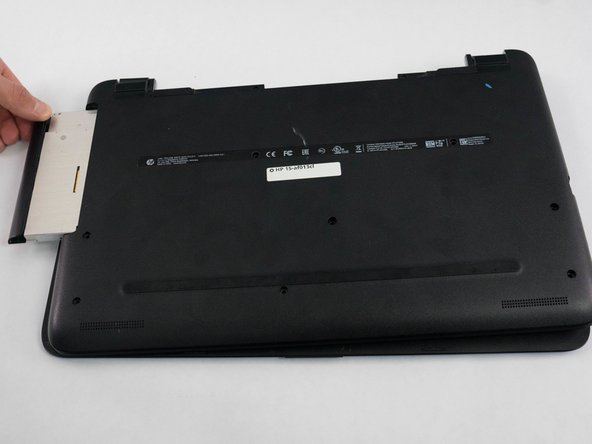

    • Remove the optical disk drive from the side of the laptop.

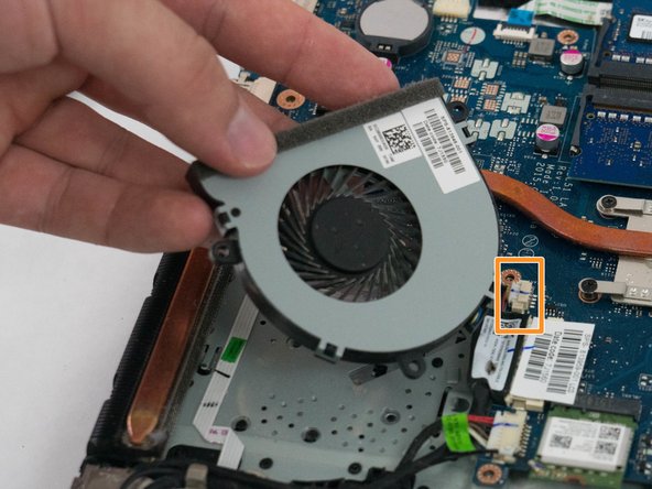

    • Begin by removing the 3 Phillips M2.0mm × 10.0mm screws of the processor fan.
    • Disconnect the fan connector from the motherboard.

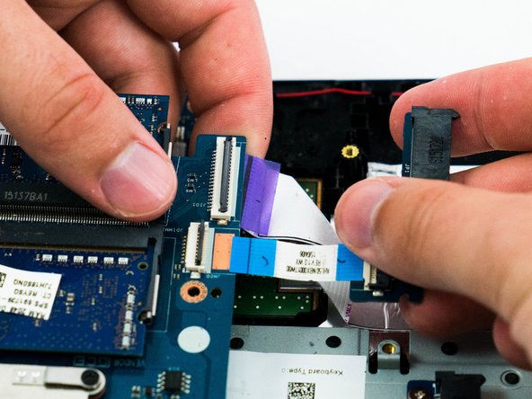

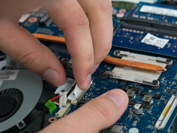

  8. HP 15-af013cl Motherboard Replacement: crwdns2935265:08crwdnd2935265:01crwdnd2935265:03crwdne2935265:0 HP 15-af013cl Motherboard Replacement: crwdns2935265:08crwdnd2935265:02crwdnd2935265:03crwdne2935265:0 HP 15-af013cl Motherboard Replacement: crwdns2935265:08crwdnd2935265:03crwdnd2935265:03crwdne2935265:0
    • Disconnect the ribbon cables for the keyboard, display, trackpad and the various system components.
    • Remove the Wi-Fi card and cables.
