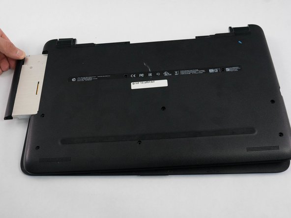

  4. HP 15-af013cl Hard Drive Replacement: crwdns2935265:04crwdnd2935265:01crwdnd2935265:02crwdne2935265:0 HP 15-af013cl Hard Drive Replacement: crwdns2935265:04crwdnd2935265:02crwdnd2935265:02crwdne2935265:0
    • Remove the optical disk drive from the side of the laptop.
  5. HP 15-af013cl Hard Drive Replacement: crwdns2935265:05crwdnd2935265:01crwdnd2935265:02crwdne2935265:0 HP 15-af013cl Hard Drive Replacement: crwdns2935265:05crwdnd2935265:02crwdnd2935265:02crwdne2935265:0

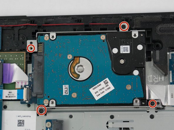

    • Lift off the bottom cover, exposing the motherboard and other components underneath.
    • Unscrew the four Phillips 3.0mm x 3.5mm screws on the hard drive bracket using the PH0 screwdriver.

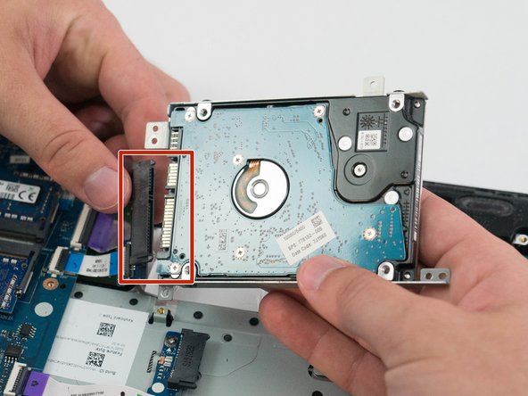

  6. HP 15-af013cl Hard Drive Replacement: crwdns2935265:06crwdnd2935265:01crwdnd2935265:02crwdne2935265:0 HP 15-af013cl Hard Drive Replacement: crwdns2935265:06crwdnd2935265:02crwdnd2935265:02crwdne2935265:0
    • Gently lift the hard drive from its position on the inside of the laptop.
    • Disconnect the ribbon cable from the hard drive.
