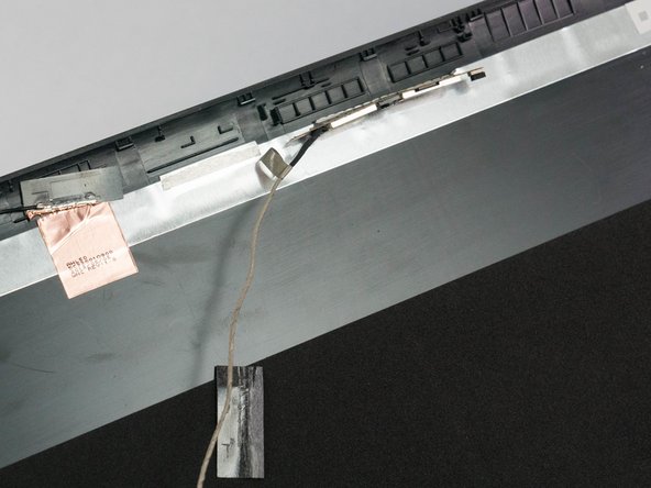

  7. HP 15-af013cl Front Facing Camera Replacement, Front Facing Camera: crwdns2935265:07crwdnd2935265:01crwdnd2935265:02crwdne2935265:0 HP 15-af013cl Front Facing Camera Replacement, Front Facing Camera: crwdns2935265:07crwdnd2935265:02crwdnd2935265:02crwdne2935265:0
    • The front camera is held in by light adhesive. Pry gently on the back of the camera in order to remove it.
    • Remove the cable from under the metal foil.

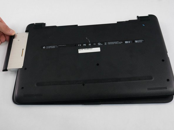

  9. HP 15-af013cl Front Facing Camera Replacement: crwdns2935265:09crwdnd2935265:01crwdnd2935265:02crwdne2935265:0 HP 15-af013cl Front Facing Camera Replacement: crwdns2935265:09crwdnd2935265:02crwdnd2935265:02crwdne2935265:0
    • Remove the optical disk drive from the side of the laptop.
  10. HP 15-af013cl Front Facing Camera Replacement: crwdns2935265:010crwdnd2935265:01crwdnd2935265:01crwdne2935265:0
    • Lift off the bottom cover, exposing the motherboard and other components underneath.
