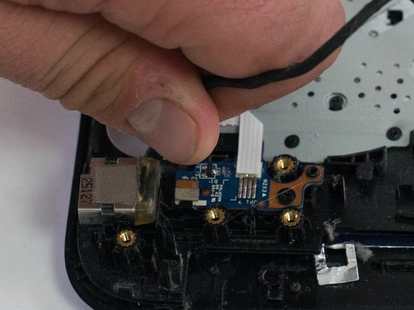

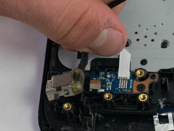

  10. HP 15-af013cl AC Adapter Replacement, AC Adapter: crwdns2935265:010crwdnd2935265:01crwdnd2935265:01crwdne2935265:0
    • Remove the 2 M2.0mm × 5.0mm Phillips screws located on the metal screen hinge closest to where the processor fan was.
  11. HP 15-af013cl AC Adapter Replacement: crwdns2935265:011crwdnd2935265:01crwdnd2935265:03crwdne2935265:0 HP 15-af013cl AC Adapter Replacement: crwdns2935265:011crwdnd2935265:02crwdnd2935265:03crwdne2935265:0 HP 15-af013cl AC Adapter Replacement: crwdns2935265:011crwdnd2935265:03crwdnd2935265:03crwdne2935265:0
    • Lift off the metal hinge from the laptop body.
    • Gently pull up on the cable leading to the charging port.
