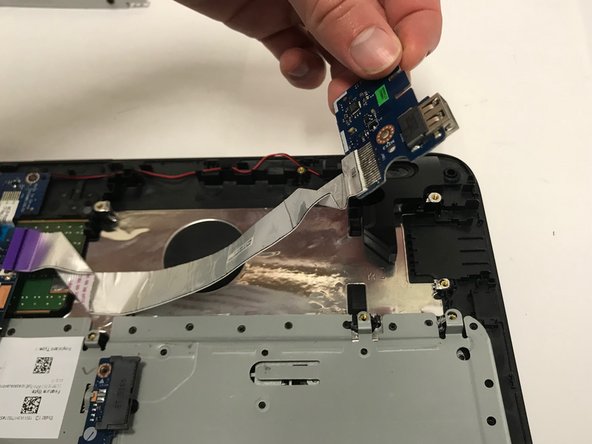

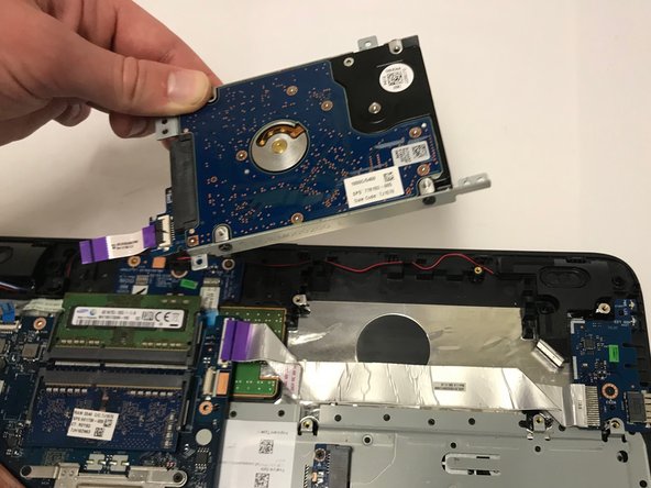

    1. HP 15-ac158dx Keyboard Replacement, Keyboard: crwdns2935265:016crwdnd2935265:01crwdnd2935265:02crwdne2935265:0 HP 15-ac158dx Keyboard Replacement, Keyboard: crwdns2935265:016crwdnd2935265:02crwdnd2935265:02crwdne2935265:0
      • Remove the Hard Drive.
    2. HP 15-ac158dx Keyboard Replacement: crwdns2935265:017crwdnd2935265:01crwdnd2935265:02crwdne2935265:0 HP 15-ac158dx Keyboard Replacement: crwdns2935265:017crwdnd2935265:02crwdnd2935265:02crwdne2935265:0
      • Lift up the cable port and place it to the side but do not remove completely from the laptop.
      • Remove the single Phillips screw securing it first.

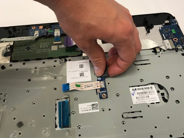

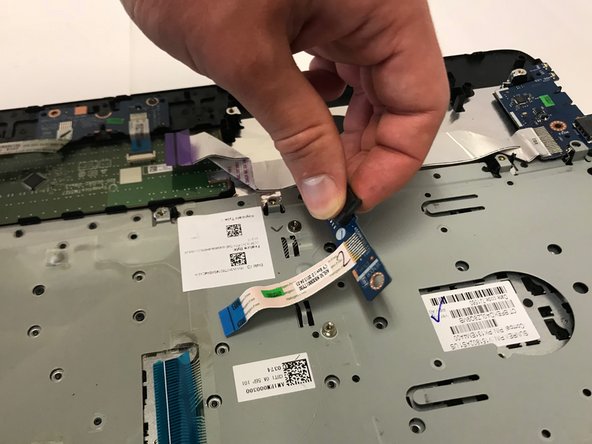

    3. HP 15-ac158dx Keyboard Replacement: crwdns2935265:018crwdnd2935265:01crwdnd2935265:03crwdne2935265:0 HP 15-ac158dx Keyboard Replacement: crwdns2935265:018crwdnd2935265:02crwdnd2935265:03crwdne2935265:0 HP 15-ac158dx Keyboard Replacement: crwdns2935265:018crwdnd2935265:03crwdnd2935265:03crwdne2935265:0
      • Remove the VENDOR component.
      • Unscrew the single Phillips screw holding it to the frame first.

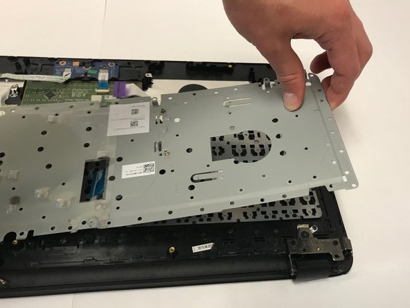

    4. HP 15-ac158dx Keyboard Replacement: crwdns2935265:019crwdnd2935265:01crwdnd2935265:02crwdne2935265:0 HP 15-ac158dx Keyboard Replacement: crwdns2935265:019crwdnd2935265:02crwdnd2935265:02crwdne2935265:0

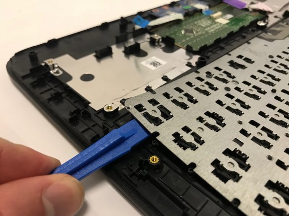

      • Using a plastic prying tools, remove the grey metal plate.
      • It will not come off easy, but do not force it off.
    5. HP 15-ac158dx Keyboard Replacement: crwdns2935265:020crwdnd2935265:01crwdnd2935265:03crwdne2935265:0 HP 15-ac158dx Keyboard Replacement: crwdns2935265:020crwdnd2935265:02crwdnd2935265:03crwdne2935265:0 HP 15-ac158dx Keyboard Replacement: crwdns2935265:020crwdnd2935265:03crwdnd2935265:03crwdne2935265:0
      • Locate the damaged keyboard and lift up with the prying tool to remove.
      • To put everything back together and use your laptop with the new keyboard, follow the steps in REVERSE..
      • ENJOY :)
