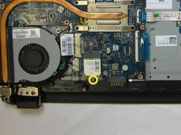

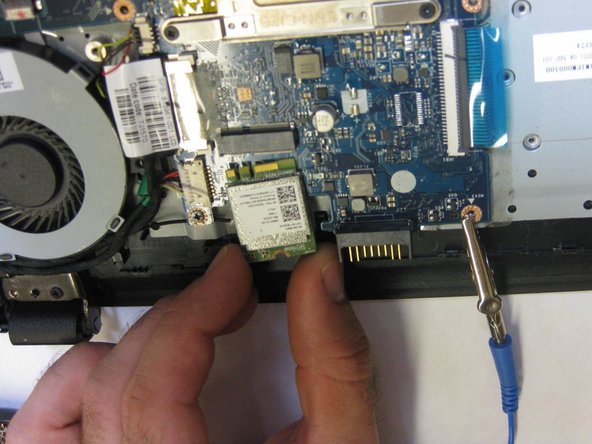

  8. HP 15-ac121dx Wifi Card Replacement, Wifi Card: crwdns2935265:08crwdnd2935265:01crwdnd2935265:03crwdne2935265:0 HP 15-ac121dx Wifi Card Replacement, Wifi Card: crwdns2935265:08crwdnd2935265:02crwdnd2935265:03crwdne2935265:0 HP 15-ac121dx Wifi Card Replacement, Wifi Card: crwdns2935265:08crwdnd2935265:03crwdnd2935265:03crwdne2935265:0
    • With the back panel removed, orient the laptop with the fan located in the bottom left corner.
    • Locate the Wifi card.
    • Using a Phillips #000 screwdriver, remove the 2mm screw securing the Wifi card in place.
    • Carefully remove the Wifi card.
