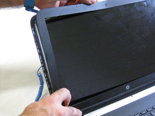

    • With the screen facing you, use the plastic opening tool to remove the liner around the screen

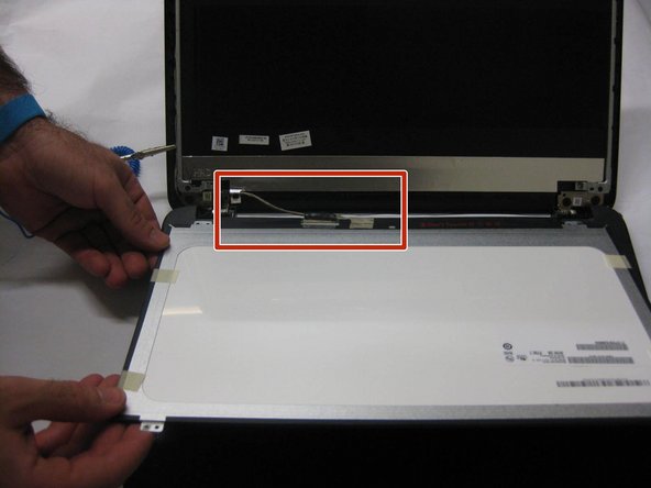

  8. HP 15-ac121dx Screen  Replacement: crwdns2935265:08crwdnd2935265:01crwdnd2935265:02crwdne2935265:0 HP 15-ac121dx Screen  Replacement: crwdns2935265:08crwdnd2935265:02crwdnd2935265:02crwdne2935265:0
    • Carefully remove the screen and place it face down on the keyboard.
    • Do not pull the screen away from the front panel assembly, as this would damage the cord connecting the screen to the front panel assembly.

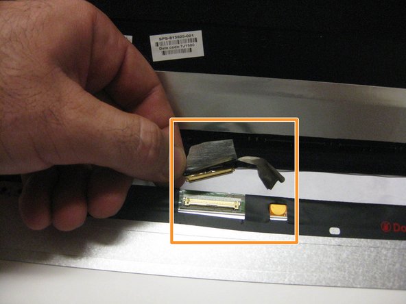

  9. HP 15-ac121dx Screen  Replacement: crwdns2935265:09crwdnd2935265:01crwdnd2935265:02crwdne2935265:0 HP 15-ac121dx Screen  Replacement: crwdns2935265:09crwdnd2935265:02crwdnd2935265:02crwdne2935265:0
    • With the screen faced down on the keyboard, remove the grounding tape adhered to the back of the screen.
    • You should see a 36-pin plug underneath the grounding tape.
    • Carefully remove the 36-pin plug, not to damage the grounding tape or the plug.
