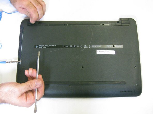

  5. HP 15-ac121dx RAM Replacement, Back Panel: crwdns2935265:05crwdnd2935265:01crwdnd2935265:02crwdne2935265:0 HP 15-ac121dx RAM Replacement, Back Panel: crwdns2935265:05crwdnd2935265:02crwdnd2935265:02crwdne2935265:0
    • Place the laptop with the back panel facing up and the battery compartment facing away from you.
    • Using a spudger, carefully remove the rubber feet on both sides of the battery compartment.
