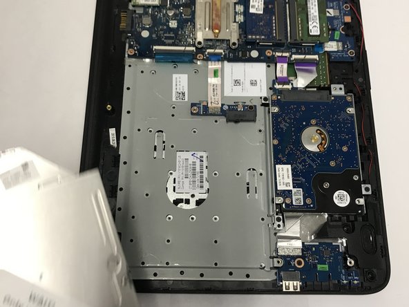

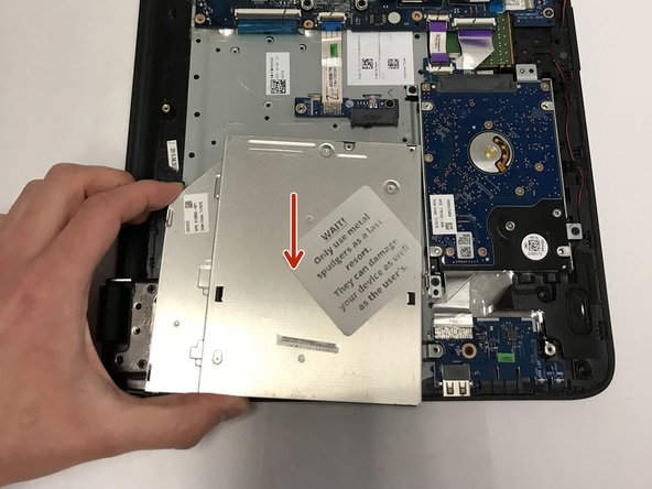

  11. HP 15-ac121dx Motherboard Replacement, CD Compartment: crwdns2935265:011crwdnd2935265:01crwdnd2935265:03crwdne2935265:0 HP 15-ac121dx Motherboard Replacement, CD Compartment: crwdns2935265:011crwdnd2935265:02crwdnd2935265:03crwdne2935265:0 HP 15-ac121dx Motherboard Replacement, CD Compartment: crwdns2935265:011crwdnd2935265:03crwdnd2935265:03crwdne2935265:0
    • Locate the CD Compartment as shown and gently slide it out.

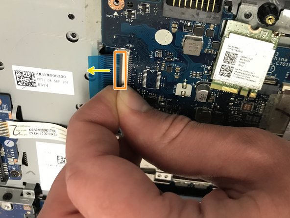

    • Locate the four ribbon clips.
    • Lift the grey part of the ribbon clips.
    • Pull the ribbon cable out and repeat this step for all four ribbon cables.
    • Also use a spudger and release the TWO cables attaching the hard drive to the motherboard. Another ribbon cable is located where the fan was sitting.

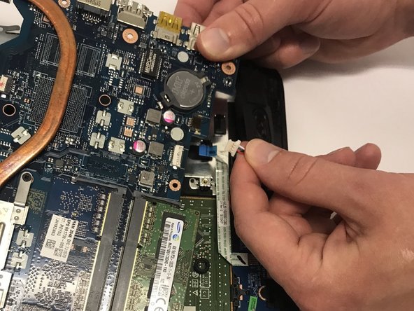

  14. HP 15-ac121dx Motherboard Replacement: crwdns2935265:014crwdnd2935265:01crwdnd2935265:02crwdne2935265:0 HP 15-ac121dx Motherboard Replacement: crwdns2935265:014crwdnd2935265:02crwdnd2935265:02crwdne2935265:0
    • Pull out the white cable (contains red and white cable attached to a black support) with wires from its port.
