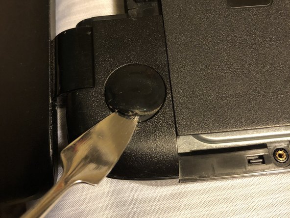

    1. HP 15-R263DX RAM Replacement, HP 15-R263DX Disassembly: crwdns2935265:04crwdnd2935265:01crwdnd2935265:02crwdne2935265:0 HP 15-R263DX RAM Replacement, HP 15-R263DX Disassembly: crwdns2935265:04crwdnd2935265:02crwdnd2935265:02crwdne2935265:0
      • Locate the two corner grips on the hinge side of the computer.
      • Using a metal spudger, remove the two corner grips to reveal the screws.

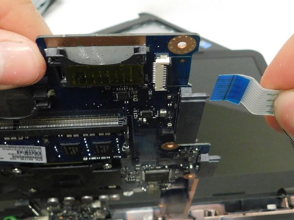

    5. HP 15-R263DX RAM Replacement: crwdns2935265:08crwdnd2935265:01crwdnd2935265:02crwdne2935265:0 HP 15-R263DX RAM Replacement: crwdns2935265:08crwdnd2935265:02crwdnd2935265:02crwdne2935265:0
      • Disconnect the other two ribbon connectors underneath the keyboard by fliping up the black clips.
      • Remove the 4 small screws shown in the picture.

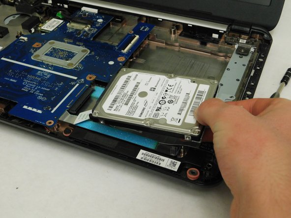

    1. HP 15-R263DX RAM Replacement, Hard Drive: crwdns2935265:010crwdnd2935265:01crwdnd2935265:01crwdne2935265:0
      • Remove the 2 black screws holding the hard drive to the computer frame.
    2. HP 15-R263DX RAM Replacement: crwdns2935265:011crwdnd2935265:01crwdnd2935265:02crwdne2935265:0 HP 15-R263DX RAM Replacement: crwdns2935265:011crwdnd2935265:02crwdnd2935265:02crwdne2935265:0
      • Gently slide the hard drive away from the motherboard to disconnect it.
      • After it's disconnected, lift the hard drive up to remove it from the computer.

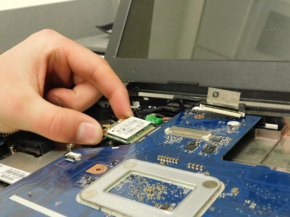

      • Remove the screw holding the WiFi chip in place.
      • Slide the chip away from the motherboard and set it elsewhere inside the computer.

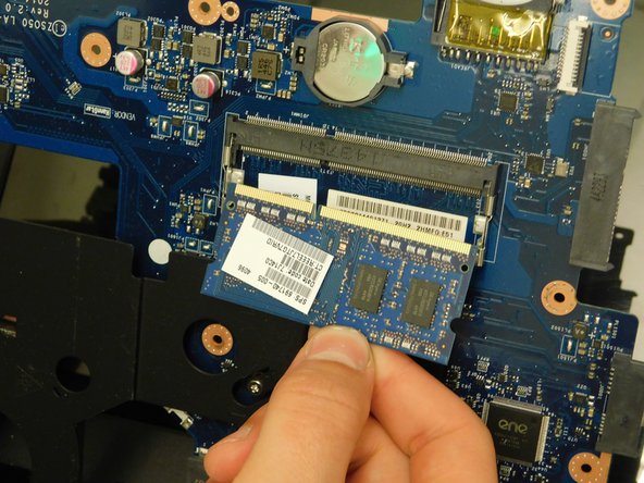

    4. HP 15-R263DX RAM Replacement: crwdns2935265:015crwdnd2935265:01crwdnd2935265:01crwdne2935265:0
      • Flip the motherboard over to access the underside revealing the RAM.
    5. HP 15-R263DX RAM Replacement: crwdns2935265:016crwdnd2935265:01crwdnd2935265:02crwdne2935265:0 HP 15-R263DX RAM Replacement: crwdns2935265:016crwdnd2935265:02crwdnd2935265:02crwdne2935265:0
      • Remove the RAM chip by simultaneously prying the 2 spring clips away from the RAM.
      • The RAM will pop up when both clips are completely released.
