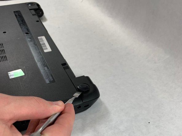

  3. HP 15-R011DX Motherboard Replacement, How to Access the Internal Components of an HP 15-R011DX: crwdns2935265:03crwdnd2935265:01crwdnd2935265:02crwdne2935265:0 HP 15-R011DX Motherboard Replacement, How to Access the Internal Components of an HP 15-R011DX: crwdns2935265:03crwdnd2935265:02crwdnd2935265:02crwdne2935265:0
    • Flip the laptop over to reveal screw locations.
    • Use a metal spudger to remove the two rear rubber feet. There are screws hidden underneath them.

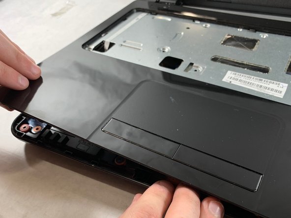

  7. HP 15-R011DX Motherboard Replacement: crwdns2935265:07crwdnd2935265:01crwdnd2935265:02crwdne2935265:0 HP 15-R011DX Motherboard Replacement: crwdns2935265:07crwdnd2935265:02crwdnd2935265:02crwdne2935265:0
    • Disconnect the two narrow ribbon cables to the left of the keyboard connection.
    • Remove five 4 mm Phillips #1 screws from the metal tray for the keyboard.
    • Pry open the plastic casing using a spudger.
    • If struggling to remove the plastic case, check that all screws have been removed.
