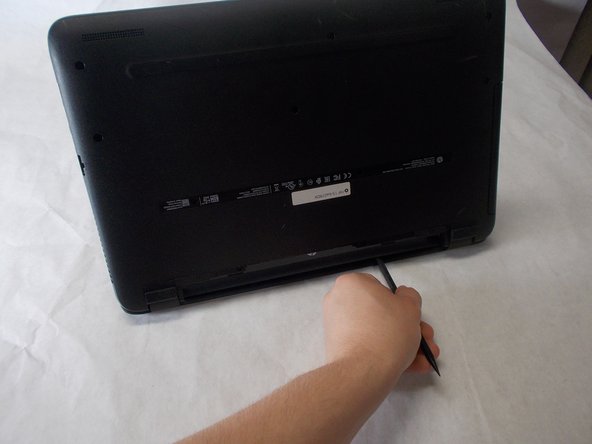

    • Unclip the two latches on the bottom of the laptop.
    • Slide the battery straight out while holding the clip open.

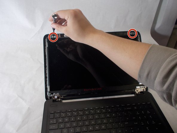

  2. HP 15-BA078DX Touchscreen Replacement, Touchscreen: crwdns2935265:02crwdnd2935265:01crwdnd2935265:03crwdne2935265:0 HP 15-BA078DX Touchscreen Replacement, Touchscreen: crwdns2935265:02crwdnd2935265:02crwdnd2935265:03crwdne2935265:0 HP 15-BA078DX Touchscreen Replacement, Touchscreen: crwdns2935265:02crwdnd2935265:03crwdnd2935265:03crwdne2935265:0
    • Carefully use the blue plastic opening tool to remove the outer frame of the screen.

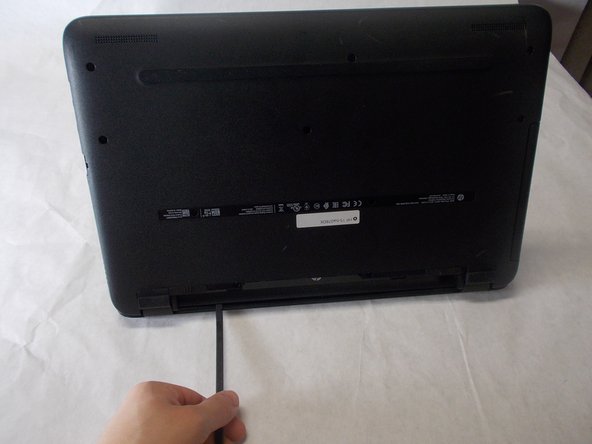

  3. HP 15-BA078DX Touchscreen Replacement: crwdns2935265:03crwdnd2935265:01crwdnd2935265:03crwdne2935265:0 HP 15-BA078DX Touchscreen Replacement: crwdns2935265:03crwdnd2935265:02crwdnd2935265:03crwdne2935265:0 HP 15-BA078DX Touchscreen Replacement: crwdns2935265:03crwdnd2935265:03crwdnd2935265:03crwdne2935265:0
    • Flip the laptop on its back.
    • Detach the bottom section of the screen frame from the laptop by using the black nylon spudger.

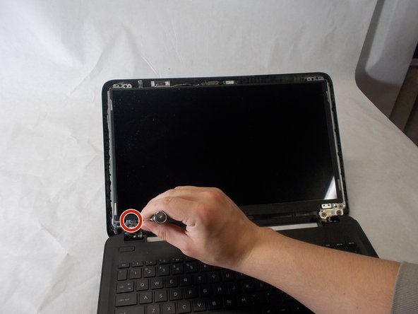

  5. HP 15-BA078DX Touchscreen Replacement: crwdns2935265:05crwdnd2935265:01crwdnd2935265:03crwdne2935265:0 HP 15-BA078DX Touchscreen Replacement: crwdns2935265:05crwdnd2935265:02crwdnd2935265:03crwdne2935265:0 HP 15-BA078DX Touchscreen Replacement: crwdns2935265:05crwdnd2935265:03crwdnd2935265:03crwdne2935265:0
    • Using the Phillips #0 screwdriver, unscrew the 4 screws around the frame.

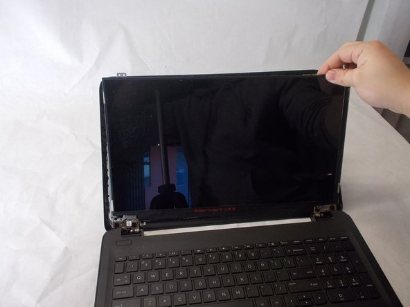

  6. HP 15-BA078DX Touchscreen Replacement: crwdns2935265:06crwdnd2935265:01crwdnd2935265:03crwdne2935265:0 HP 15-BA078DX Touchscreen Replacement: crwdns2935265:06crwdnd2935265:02crwdnd2935265:03crwdne2935265:0 HP 15-BA078DX Touchscreen Replacement: crwdns2935265:06crwdnd2935265:03crwdnd2935265:03crwdne2935265:0

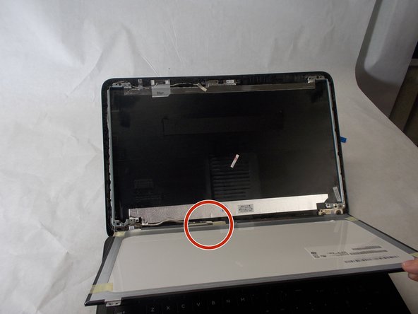

    • Remove the touchscreen from the laptop.
    • Be careful not to damage the screen connector located at the bottom of the screen.
