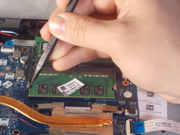

  7. HP 15-BA078DX RAM Replacement, RAM: crwdns2935265:07crwdnd2935265:01crwdnd2935265:02crwdne2935265:0 HP 15-BA078DX RAM Replacement, RAM: crwdns2935265:07crwdnd2935265:02crwdnd2935265:02crwdne2935265:0
    • Using a plastic spudger, unclip the latch locking the RAM to the motherboard.

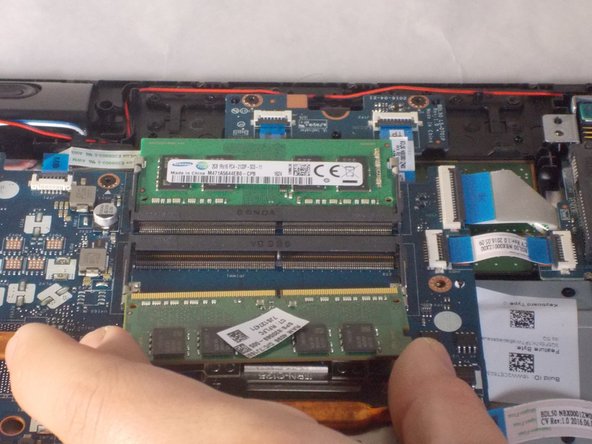

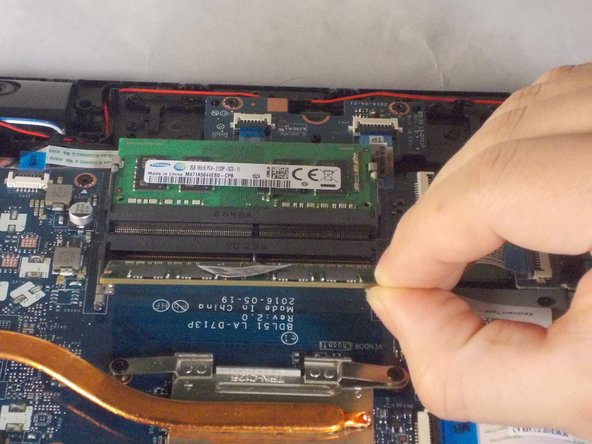

  8. HP 15-BA078DX RAM Replacement: crwdns2935265:08crwdnd2935265:01crwdnd2935265:03crwdne2935265:0 HP 15-BA078DX RAM Replacement: crwdns2935265:08crwdnd2935265:02crwdnd2935265:03crwdne2935265:0 HP 15-BA078DX RAM Replacement: crwdns2935265:08crwdnd2935265:03crwdnd2935265:03crwdne2935265:0
    • Gently tilt the RAM sticks up and slide out each stick.
