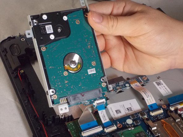

  7. HP 15-BA078DX Hard Drive Replacement, Hard Drive: crwdns2935265:07crwdnd2935265:01crwdnd2935265:02crwdne2935265:0 HP 15-BA078DX Hard Drive Replacement, Hard Drive: crwdns2935265:07crwdnd2935265:02crwdnd2935265:02crwdne2935265:0
    • Using a black nylon spudger, disconnect the black connector that attaches the hard drive to the motherboard
  8. HP 15-BA078DX Hard Drive Replacement: crwdns2935265:08crwdnd2935265:01crwdnd2935265:01crwdne2935265:0
    • Using the Phillips #0 screwdriver, unscrew the three screws holding the hard drive down to the board.
  9. HP 15-BA078DX Hard Drive Replacement: crwdns2935265:09crwdnd2935265:01crwdnd2935265:03crwdne2935265:0 HP 15-BA078DX Hard Drive Replacement: crwdns2935265:09crwdnd2935265:02crwdnd2935265:03crwdne2935265:0 HP 15-BA078DX Hard Drive Replacement: crwdns2935265:09crwdnd2935265:03crwdnd2935265:03crwdne2935265:0
    • Remove the hard drive.

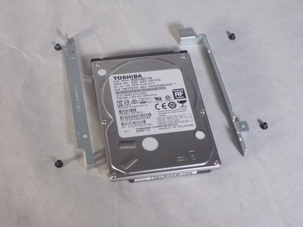

  10. HP 15-BA078DX Hard Drive Replacement: crwdns2935265:010crwdnd2935265:01crwdnd2935265:02crwdne2935265:0 HP 15-BA078DX Hard Drive Replacement: crwdns2935265:010crwdnd2935265:02crwdnd2935265:02crwdne2935265:0
    • Using the Phillips #0 screwdriver, unscrew the four screws from the holding apparatus.

Can you provide the HDD model number for replacement? Also the model number or description of a compatible HDD with higher capacity.
Thank You

Today, while disassembling my HP 15-BA078DX I had an issue trying to get the shell apart. I didn't realize that there was a screw under each rubber foot by the hinges. It would have saved me a whole lot of trouble had I known that. Very important to get those 2 screws out, otherwise you will risk breaking out the corner on the backside of the keyboard tray....... like I did. Fortunately for me, I was able to use some 2-part epoxy (the kind that works on plastic) to glue the hinge back down to the shell. Had the author pointed out those 2 screws in particular, in the pictorial, things would have gone way easier. Hopefully, this will help the next guy.
Eric S - crwdns2934203:0crwdne2934203:0
btw.........you will also need a #1 phillips screwdriver if you plan on removing the hard drive.
