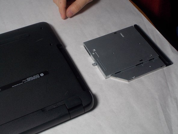

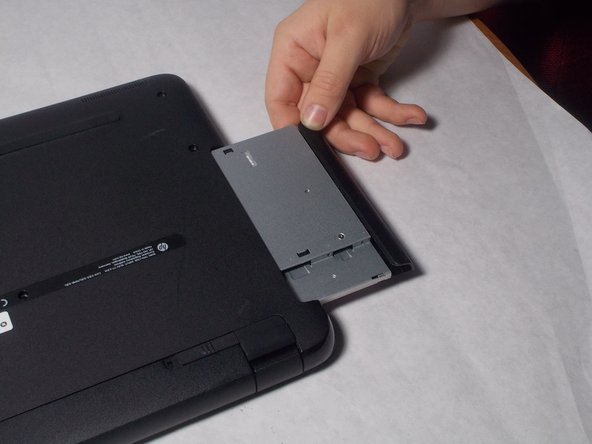

  2. HP 15-BA078DX Back Panel Replacement, Disc Drive: crwdns2935265:02crwdnd2935265:01crwdnd2935265:01crwdne2935265:0
    • Using the Phillips #0 screwdriver, remove the 7.5mm screw from the underside of the plastic frame that holds the disc tray in place.
  3. HP 15-BA078DX Back Panel Replacement: crwdns2935265:03crwdnd2935265:01crwdnd2935265:03crwdne2935265:0 HP 15-BA078DX Back Panel Replacement: crwdns2935265:03crwdnd2935265:02crwdnd2935265:03crwdne2935265:0 HP 15-BA078DX Back Panel Replacement: crwdns2935265:03crwdnd2935265:03crwdnd2935265:03crwdne2935265:0
    • Remove the disk tray assembly by sliding it out from the side using the blue plastic opening tool.

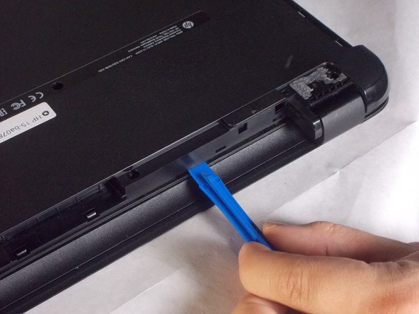

  4. HP 15-BA078DX Back Panel Replacement, Back Panel: crwdns2935265:04crwdnd2935265:01crwdnd2935265:01crwdne2935265:0
    • Remove all of the remaining back panel screws with a #0 Phillips head screwdriver.
    • Remember to remove the two screws under the rubber feet.

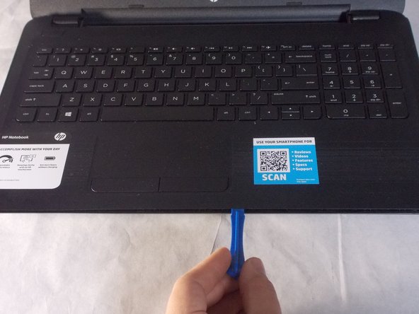

  5. HP 15-BA078DX Back Panel Replacement: crwdns2935265:05crwdnd2935265:01crwdnd2935265:03crwdne2935265:0 HP 15-BA078DX Back Panel Replacement: crwdns2935265:05crwdnd2935265:02crwdnd2935265:03crwdne2935265:0 HP 15-BA078DX Back Panel Replacement: crwdns2935265:05crwdnd2935265:03crwdnd2935265:03crwdne2935265:0
    • Carefully use the blue plastic opening tool to pry the clam shell of the laptop apart.
    • You may need to flip the laptop over to unlatch all of the internal clips.

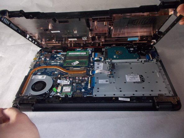

  6. HP 15-BA078DX Back Panel Replacement: crwdns2935265:06crwdnd2935265:01crwdnd2935265:03crwdne2935265:0 HP 15-BA078DX Back Panel Replacement: crwdns2935265:06crwdnd2935265:02crwdnd2935265:03crwdne2935265:0 HP 15-BA078DX Back Panel Replacement: crwdns2935265:06crwdnd2935265:03crwdnd2935265:03crwdne2935265:0
    • Carefully pull the shell of the computer apart.

Thank you so much! I know I am probably the only or one of the few people to write a comment for this specific laptop but I wanted to upgrade the RAM and HDD to SSD. Have a great day
