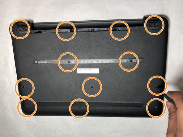

    • The first step of this process is to peel off two rubber feet from the bottom of the laptop.
    • Then remove twelve 8.8 mm screws using the Phillips #0 Screwdriver.
  6. HP 15-AF131DX Wireless Network Card Replacement: crwdns2935265:06crwdnd2935265:01crwdnd2935265:03crwdne2935265:0 HP 15-AF131DX Wireless Network Card Replacement: crwdns2935265:06crwdnd2935265:02crwdnd2935265:03crwdne2935265:0 HP 15-AF131DX Wireless Network Card Replacement: crwdns2935265:06crwdnd2935265:03crwdnd2935265:03crwdne2935265:0

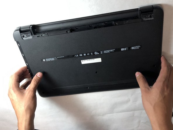

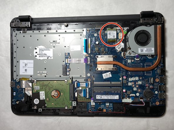

    • Remove the bottom of the plastic case using a blue plastic opening tool.
    • The HP Wireless Network Card is found in Picture 3, circled in red.

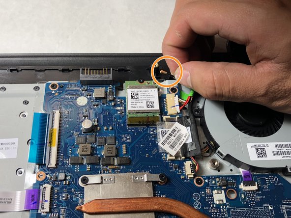

    • Remove one 3.3 mm screw using Phillips #0 screwdriver.
    • Pop off the connection wire by pulling the wire upwards off the stud on the HP Wireless Network Card.

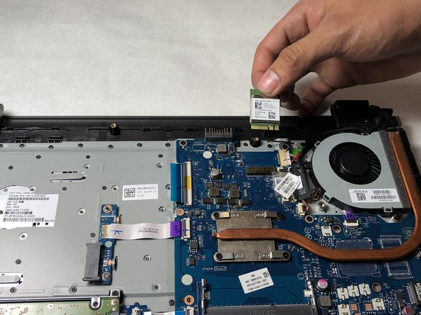

    • Pull out the HP Wireless Network Card.
