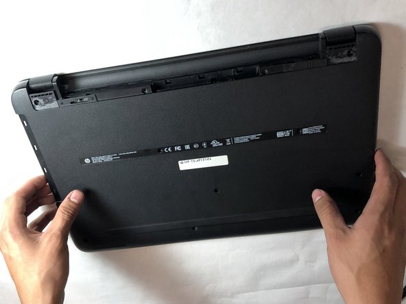

    • Turn the computer upside down on a level surface.
    • Slide the battery lock to unlock the battery.
    • Slide the battery release latch. The latch will click when the battery is released.
    • Lift the battery from the middle to remove it from the computer.
    • The latch will click again when a battery is reinstalled. Switch the battery lock back to locked after reinstalling a battery to keep it secure.

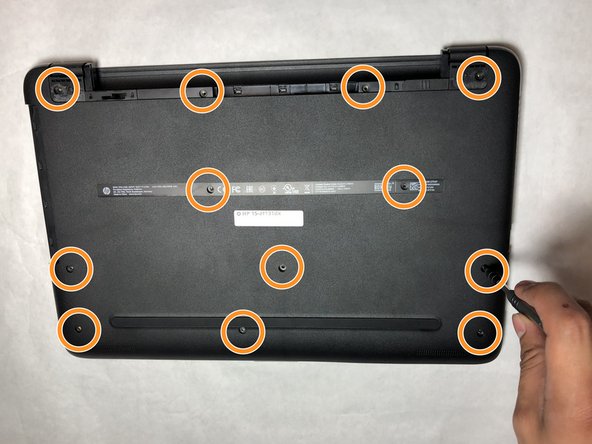

  5. HP 15-AF131DX Trackpad Button Circuit Board Replacement, Trackpad Button Circuit Board: crwdns2935265:05crwdnd2935265:01crwdnd2935265:02crwdne2935265:0 HP 15-AF131DX Trackpad Button Circuit Board Replacement, Trackpad Button Circuit Board: crwdns2935265:05crwdnd2935265:02crwdnd2935265:02crwdne2935265:0
    • Remove two rubber feet by peeling them off.
    • Remove twelve Phillips head 8.8mm screws using the Phillips #0 Screwdriver.

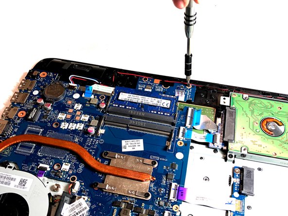

    • Remove the two 3.3mm Phillips-head screws that secure the trackpad circuit board to the top cover.

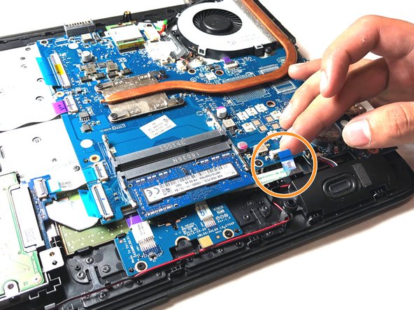

  8. HP 15-AF131DX Trackpad Button Circuit Board Replacement: crwdns2935265:08crwdnd2935265:01crwdnd2935265:02crwdne2935265:0 HP 15-AF131DX Trackpad Button Circuit Board Replacement: crwdns2935265:08crwdnd2935265:02crwdnd2935265:02crwdne2935265:0
    • Lift the plastic wire lock bracket.
    • Pull on the blue tab to remove the wire using the tweezers tool to make sure there is no damage as you pull.

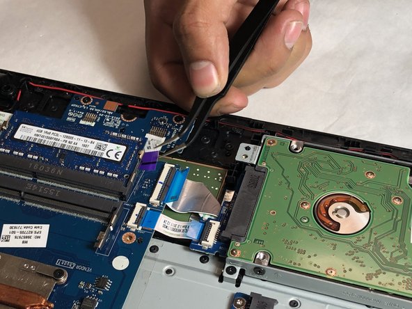

  9. HP 15-AF131DX Trackpad Button Circuit Board Replacement: crwdns2935265:09crwdnd2935265:01crwdnd2935265:02crwdne2935265:0 HP 15-AF131DX Trackpad Button Circuit Board Replacement: crwdns2935265:09crwdnd2935265:02crwdnd2935265:02crwdne2935265:0
    • Lift the second plastic wire lock bracket.
    • Pull on the purple tab using tweezers to remove the wire.
