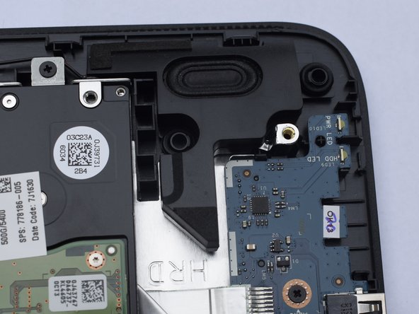

    • Turn the computer over and use a plastic card, opening pick, or opening tool to pry the space between the keyboard and bottom surface of the computer.
    • Work plastic card, opening pick, or opening tool carefully around the three edges (excluding the side with the screen, which should be positioned at 90 degrees.
    • Gently lift the top surface of the bottom half of the laptop, revealing the speakers.

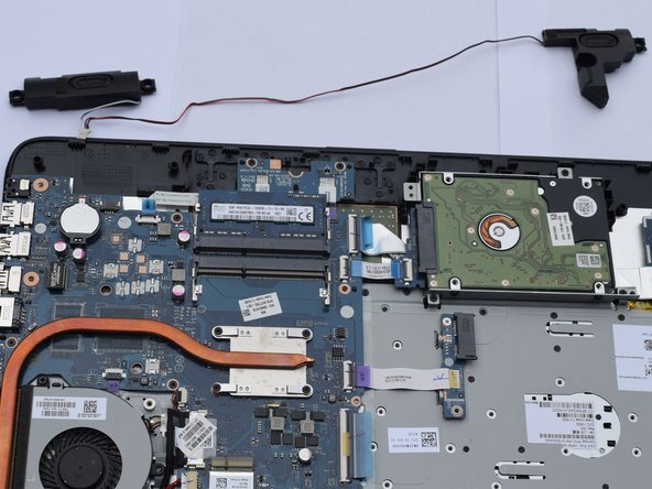

    • Pull up on each individual speaker, removing the rubber holds from their plastic pins.
    • Unplug the wire that connects the speakers.
    • Carefully remove the speakers from their plastic holds.
