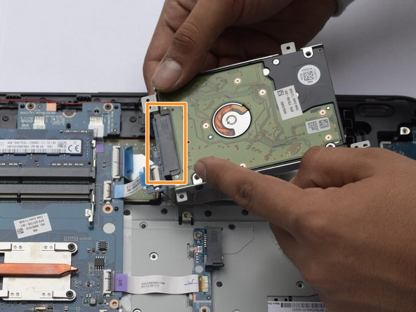

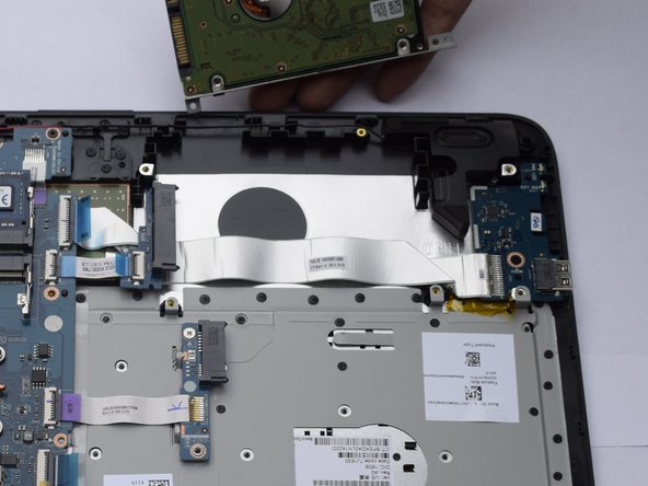

    • Remove the three screws that hold the hard drive in place.
    • Lift the hard drive slightly and disconnect the SATA hard drive connector to free the hard drive.
    • Remove the hard drive.
